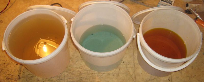

You'll need, to work at ease, three plastic tanks (4-5 liters) with a cover to avoid some contamination of the electrolyse and safety when you don't use them.
The first will contain the electrolyte bath, the second, the clear/blue passivate, the third, the yellow/gold passivate.
You'll need too a 10 litres bucket filled with water to rinse the items you've plated before immersing them into the passivate baths.
Here's a picture of the plastic tanks containing the electrolyte bath (left), clear/blue passivate (middle), and yellow passivate.
The diameter of the tanks is about 8", and the height 8.5"

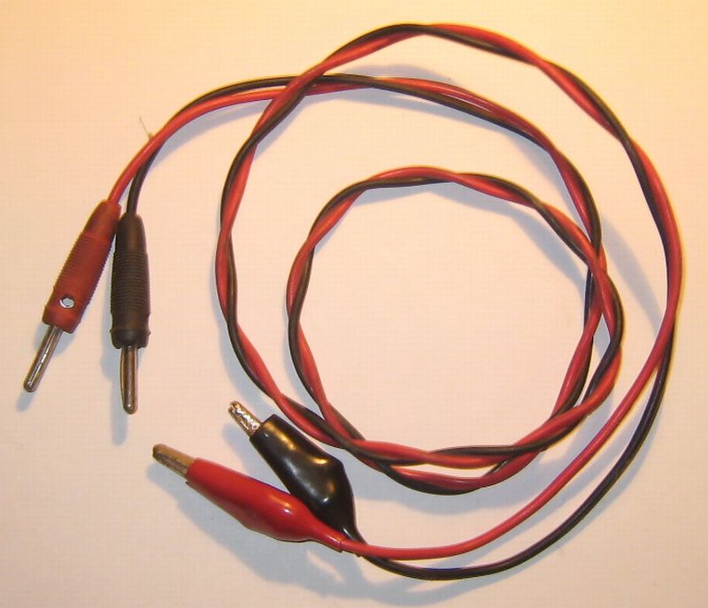

The copper wires
You need two sets of wires, the first to connect the power supply to the anode and the item to be plated,
and the second to hang the items into the electrolyte bath.
When you buy a kit, you only get the thin copper wire, to hang the items.
I recommand to get some big electric wire, to plate easily many bolts at the same time - imagine to have one wire for one nut ! The wire must be thick enough to support the weight of the nuts. But look at the picture to understand :

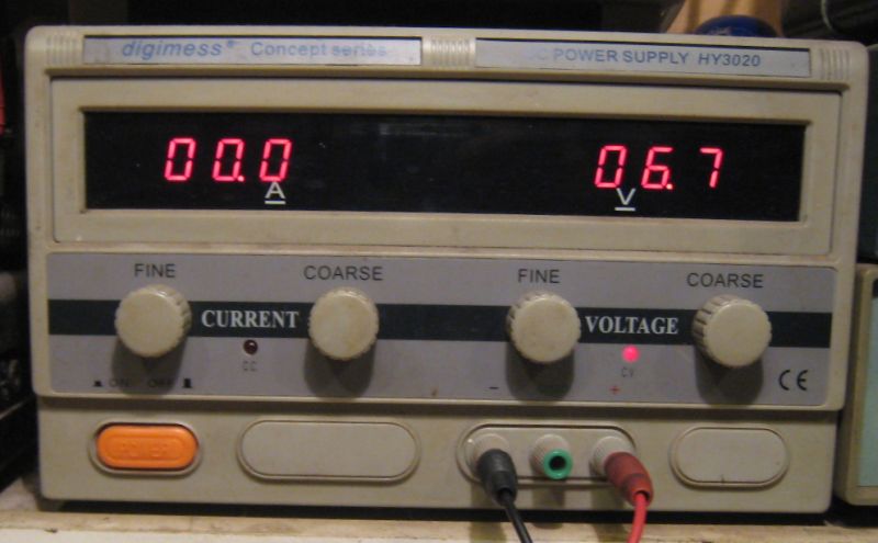

First, I'm going to try to explain you what's is happening in relation of the voltage and the current.
- The voltage : it's easy, don't look at it ! The current depends of the voltage, and here, only the current is to be considered. (the voltage between the anode and the item is often below 1 DCV)
- The current : here we are ! It's one of the most important things to get right.
I can tell you what amperage is ideal, but it depends on the size of the items beeing plated (and to a lesser degree the temperature of the electrolyte).
There's no ideal voltage, but there's an ideal current. I tried many possibilities, and I found that the ideal current is 100 mA per100cm², or 65 mA per square inch.
If you don't take care of the ideal current, you can't get two problems :
- if the current is too low, the plating will take too long time and get dark and/or dull areas
- if the current is too high, the plating is too fast, and the zinc deposit is rough and grey with dark patches in the most high current density areas
- if the current is very too high you could burn the electrolyte and/or the make-up
----> so, the best way is always to set the power supply controls (voltage and/or intensity) at the minimum on starting.
The best power supply is powerfull, with both controls of the voltage and the intensity. You can adjust the voltage and the current but like I said before, only adjust the voltage, and by the same way the current will vary because I=U/R.

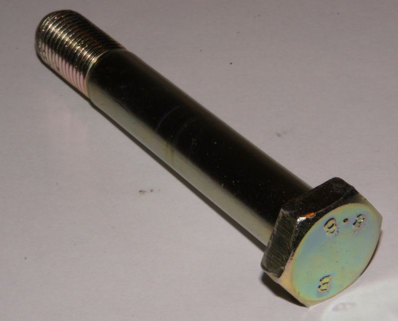

When you begin electroplating, always measure the area of the item beeing plated.Question ? do you know the surface of the front bolt of the rear trailing arm ?
I don't know too. So, let's measure approximatively. (there are some sofwares to calculate)
- The surface of the cylinder is : 2 * Π* A 2 + 2 * Π* A * B = 38 cm²
- The surface of the head is : 6 x (1.2 x 0.6) = 4,32 cm²
Total is 42 cm² or 6,5 square/inches. Did you think it was so large ?
The current needed to plate this bolt is then : 6,5 x 65 (mA)= 420 mA or 0,42 A
I did it and here it is :

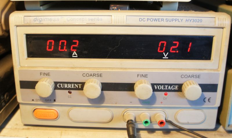

3/ connect the zinc anodes to the power supply (for these two little parts, you can see the intensity of the current I use), the positive to the zinc, the negative to the part that is to be plated. Begin with the smallest current, and increase it to the intensity required by the surface of the parts.
4/ Connect your little fishpump (it will improve the plating)
5/ If you everything is right, it will look like this :

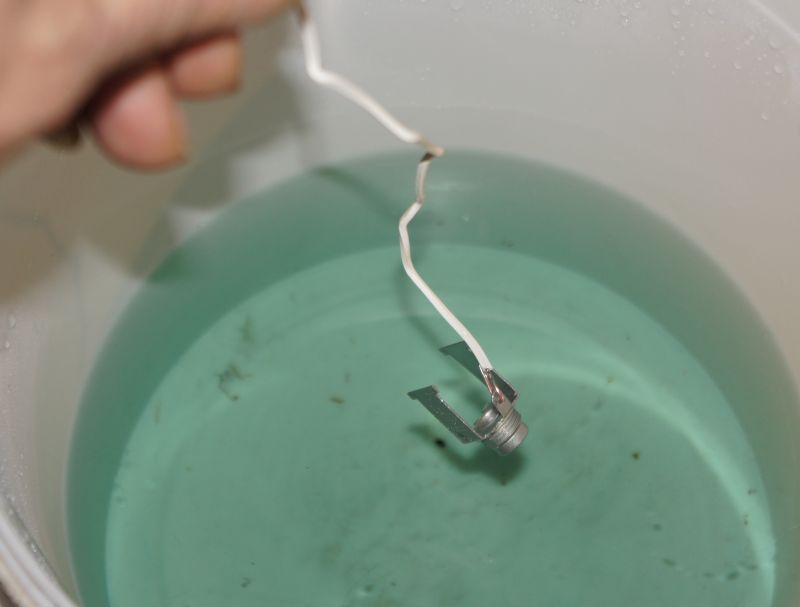

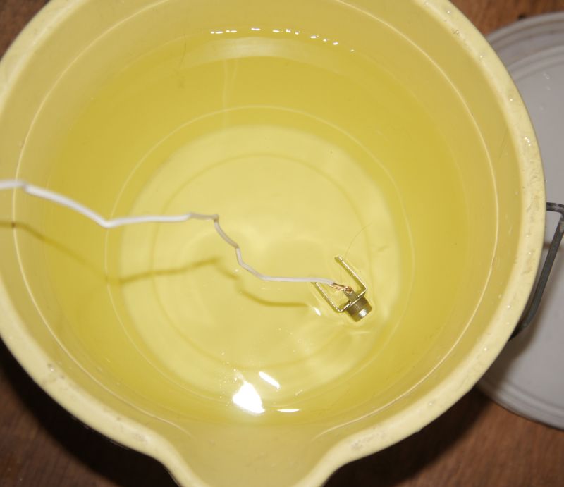

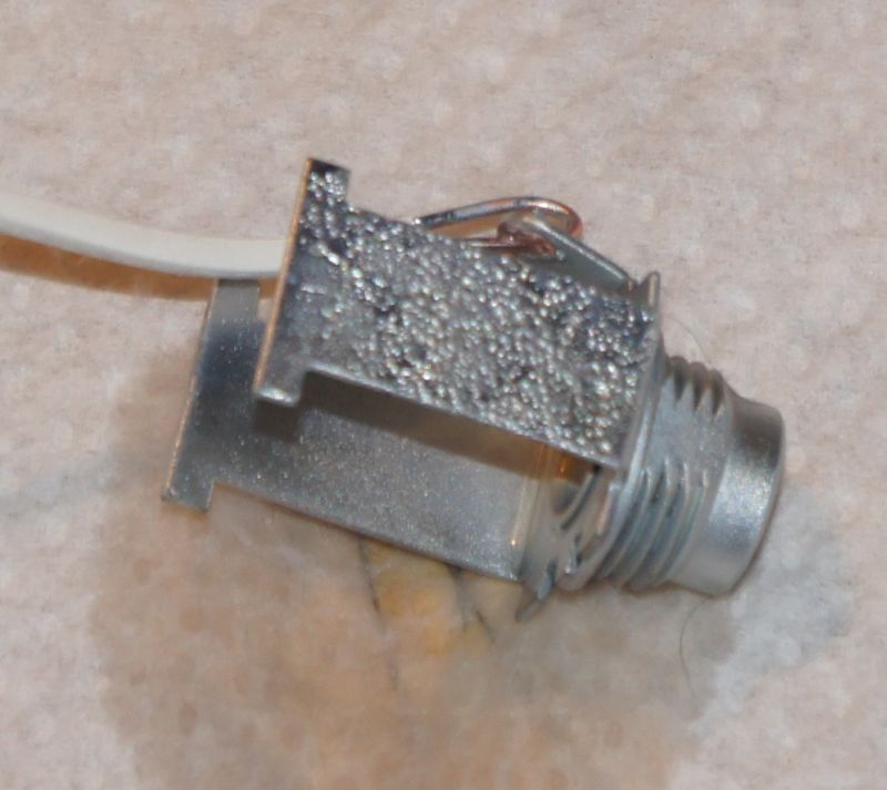

7/ It time now to clear/blue passivate the parts : rince the part in the bucket of water :
You can see how the jack socket looks :
set your timer for 30 seconds,
then immediately immerse the part in the clear/blue passivate
after 30 seconds, remove the part and rinse it again - you can see on the following picture how looks the jack socket :

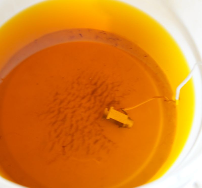

8/ Rinse again in the water the part, and go into the yellow passivate,
from 45 seconds if you want a light yellow color, to 75 seconds if
you want a more coloured appearance. I let my socket for 60 seconds.

The tanks :
The copper wires
The power supply
Electroplating needs a DC current source.
Here's a picture of mine : 0-30 Vots, 0 - 20 amp :
