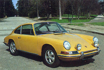

I installed similar fog lights mounted on my old 911, and I had to attach an adjustable long screw between the spoiler and the rear of the lights to avoid the unpleasant vibrations and adjust easily the best position.
The lights you installed seem to me a little too large and not enough simple.
