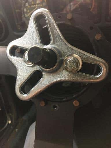

Guys, am I missing something? I removed the center nut on the steering wheel and I am cranking down on my puller but this thing is not budging.
Is there another fastener other than the center nut?

Hope you left the nut on flush or you might mushroom the top threaded area. I had the same problem on 2 different cars. The steering wheel was really on there on both cars. If you took the nut off completely put it back on flush and then put a thick washer on top with a smallish hole to keep everything stable then tighten down after you put some bp blast or any good penetrant oil and rap on the top with a brass hammer and repeat while there is tension on the wheel. I pulled the threads out on my wheel like yours and had to tap 1/4" sae fine thread to finally get the job done.

No it's just the one nut. Sometimes it is a real bi%$ch to get off.
Some guys put pressure on the wheel puller and spray with BB blaster and go
have a round of golf. There's a lot of Aluminum there so be careful.
I would (after a couple rounds of golf) add a little torque on that center bolt.
Go take the trash to the dump, add a little torque, take the grand kids for ice cream,
bang on the wheel, add some torque to the bolt, make up some new words
that you don't want you grand kids to learn, decide that the wheel does not really have to come off...
That's what I did..:LOL:.

Wow that took way more force than I was expecting!!!
I think I may put some anti seize on there to make future removal, if ever I need to, slightly easier!
