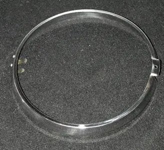

Decided since it doesn't have the internal studs as well, I'm going to keep them external but go with the thinner chrome trim rings from Re-Originials. Looks like it will be the best solution with regarding to ease of install and adjustment and looks.

Certainly faster and less complicated. You’ll still have to make the slots for the locating tabs on the fairing covers as well as the hold down brackets.

Welp back to square one, Re-Originals says that, despite have them listed on their site, they haven't have them available since 2021. LOL. Only option now is either forego the headlight covers, so try and design and 3D print something myself.

Without the studs, I think the only choice you have is the exterior mount. I have a pair of the thin headlight rings but will likely keep hanging onto them until someone makes me an offer I can't refuse.:)
Did you buy the covers? If so, did you confirm that they fit your nacelle? At some point in the 80's Alfa changed the shape slightly and the covers don't fit. Also as @not2old4toys pointed out, even with the thin rings you need to cut 2 tabs into the surround to accept the tabs on the covers. And more obviously drill a hole at the leading edge for the clampdown.

Heard back from re-originals they were able to source some, so looks like I'm in luck. Once I get them I'll see if I can get a good 3D scan of them in order to get a model together that could be 3D printed.
