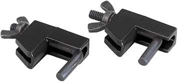

For those of you that brought back this old thread I have additional
info. Instead of pulling the fuse, I just use one of these.
I just install one of these on the fuel hose.
A great time saver...
#15 ·
@samakijoe, yeah-well-no thanks. Maybe I'd use them on a known new hose on a used car that I'm selling to stranger out of state. In my experience, when you crush a rubber hose like this it is possible to damage it; make a weak point where it will fail in the future. I know flat rate guys who pinch (crush) fuel hoses, coolant hoses, even brake hoses, all the time. When I frown about this, they say, well, if it fails in the future it's just more paying work...

Andy: I except the spanking. Been spanked before and it will happen again...;)
I guess I should have mentioned the "rules" I follow when using these clamps in the shop and other places.
These are some of the rules, but not all for it's uses: :
1. Never clamp using a 12" crescent wrench.
2. never use the same location on the hose twice.
3. Remember to remove it at the point I want to try to restart the engine. (happens all the time)
4. They are small. So store them in a "special" place.
I hang mine on a string off my pencil sharpener. always in plan view. Just like in high school shop class.
