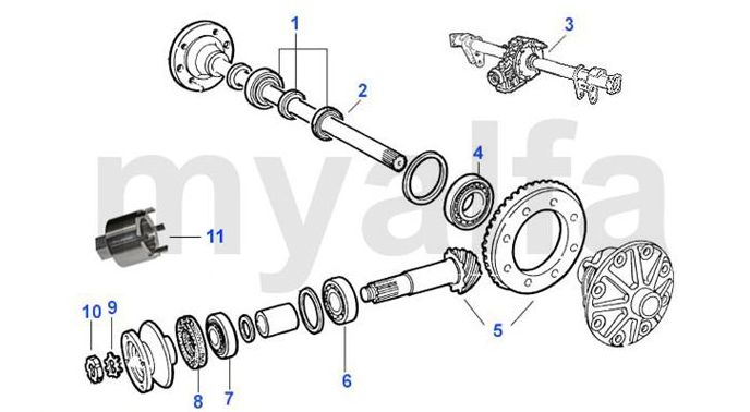

Does anyone know where I can buy this nut, mine is in very bad condition ?
It's the part 10 on the picture

There are two sizes for the pinion nut. Depends what car you have?
the illustration you show above is from a very good German firm I often use, Bertelsbeck Alfa - why don't you just get it from them? (Pinion Nut = Mutter Antriebsflansche in German, that'll keep you busy:)) they seem to have both the small one and the large one, depending if your car is a 1600/1750 or 2 litre. 40 bucks for the expensive one, 15 bucks for the other! [EDIT: that includes 19% german purchase Tax, which you will not have to pay, being in the States, or at least you will get back]

You will need the Pinion nut tool to take it off and torque it back, so if you need it, try either "totallyalfa" who are specialised in making aftermarket tools:
Pinion/Crankshaft Nut Tool - A.5.0114 (A.5.0114 ) :: TotallyAlfa
or this guy (if he still is around) on alfabb:
http://www.alfabb.com/bb/forums/alf...67588-71-93-alfa-romeo-pinion-nut-socket.html
or make your own!
The Art of Tool Making or, How to Make a Differential Pinion Nut Removal Tool
hope that helps and good luck!
