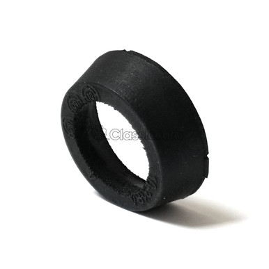

Also this rubber piece under the shifter handle. If it slightly looks like its about to break. Go ahead and replace it. They break and fall of. When that happens its lets the shifter plates on top rattle around.
