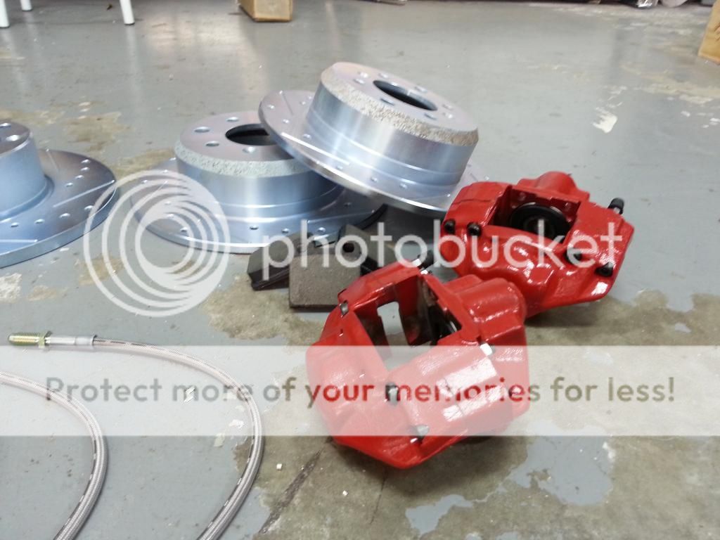

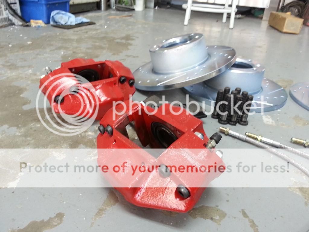

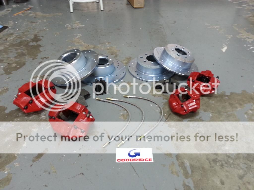

Hello, my name is Joey, and i am new to the forum. I have done some research on this subject, and i cant seem to find people that have had the same exact issue. Basically, to make a lot story short I i recently purchased my first alfa spider:001_tongue: . When i got it home i realized the brakes were TERRIBLE! They were like glue every time i depressed the brake! So, needles to say i bought master cylinder, lines, brakes, rotors, and rebuilt the calipers. Due to the overwhelmingly low price i bought the car at i was prepared to put in the cash and labor. After that fact they worked perfectly. Until after a few miles or so they lightly stick for a brief moment and come back to normal (almost every time i depress the brake). Could it be that the pistons in the calipers are expanding a bit and cause some stick? Could it be something as simple as a weak return spring on the brake pedal? Or maybe my expectations are to high? Or maybe all lol? Any thoughts? Here are some pics of the parts i rebuilt/installed.

The rotors pictured... All the front rotors I have ever seen, and installed had lug studs already in them. Why do the ones you have pictured (only the fronts) not have that?
