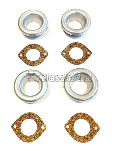

I was also e-mailing with our friends at Alfaholics on what I envision for my Giulia. I simply love the deep growl of the dual webers and realize there is no HP gains via the intake. For those interested, I decided on these with socks:
For a little extra HP and noise I went with this exhaust set up:
I am keeping all the OG parts so anyone can take it back to stock in the future. This is all about experimentation and having a blast while doing it. Thanks again..

Cams would have been better money spent that extractors. Alfa knew what they were doing and didn't have to worry about emissions back then. But you are enjoying your car, which is what counts
