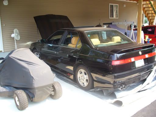

Hey guys I haven't posted any pics up lately so I thought I might do it now before winter hits. Sam asked me to post some up after I picked up his nice set of wheels today for my sisters 164L (Thanks Sam!)

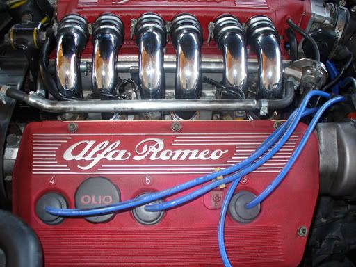

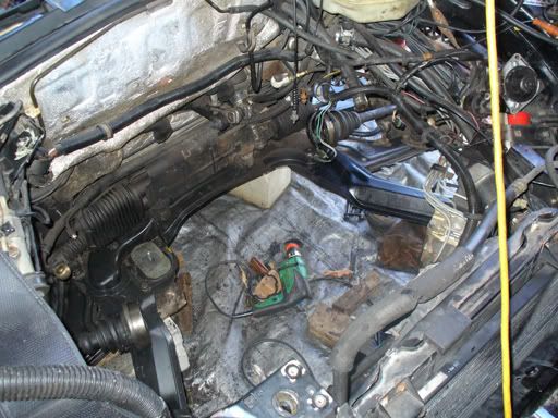

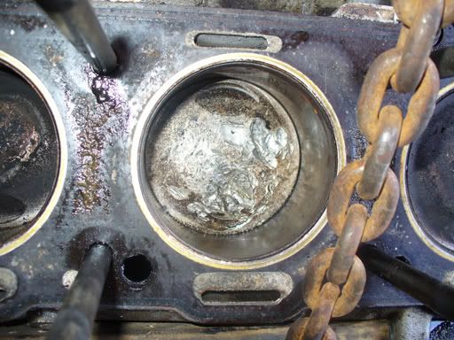

Anyway, this summer my engine blew (see the nasty pics below). So after a nice fresh rebuild and implant of another S motor, the car is running beautifully. We definitely learned a lot while swapping/rebuilding the motor, and I have to give a lot of credit to the BB, using the search function really helps!

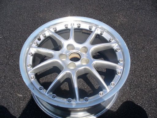

While the car was out of commission, I added KONI adjustable shocks with B+G springs from Jason. The car handles awesome with the suspension and my 225/45 Toyo proxes. I also bought a set of hubcentric adapters form Charlie DiMarco, which allowed me to use the 17x7.5 BBS RK-II wheels that I recently refurbished. Then I also added a 8000K HID kit to my euro projectors, a night a day difference. Anyway here are some pics:

Nice job. Black is a awesome color for the S. How many miles since installation, on the "new engine" ?
No snow yet in CT, so you must still be driving her. Happy motoring!

Thanks guys!
I've put about 2,500 miles since everything was finished in July.
The adapters convert to 5x100. I had a different set of wheels with the wobble bolts, and I could never get them to be perfectly centered, even with hubcentric rings. So I chose to go a different route. The back of the adapter is hubcentric to the alfa hub (57.1mm), and the front portion that protrudes out is hubcentric to a vw hub (58.1mm). Basically you just bolt it onto your hub and then put the wheel on the studs with the lugs that Charlie gives you. The wheel just needs to have pockets on the backside for the bolt heads. Here are some pics.

Good to hear how you turned the blown engine situation into an opportunity to refurbish your S. She looks great - excellent engine cosmetics and great overall upgrades!

I like all the upgrades and work done as well. Paint looks fantastic too.

Very nice! I love the look of the lower skirts painted to match on black 164's, it seems like the only color that can pull it off on the 164. Nice engine bay too!
Is that a Zender front lip (or is it called air dam/chin spoiler..not sure)? If it's not Zender (which I know is unavailable) where did you get it?

I made the front lip by laying fiberglass over foam that I had shaped to size. I also shaved the headlight washers and cut out/smoothed the grill slats. I used layers of bondo and plastic to smooth it all out. I took it of for the winter and I am going to try to improve the design.

the timing belt must have slipped and piston #2 chewed up its vavles pretty good and blew a hole in the valve bowl
Also forgot to mention that one of the connecting rods that I pulled out was shaped like a banana. My guess was that it was hydro locked from the coolant that flooded the intake. Coould it be something else?
