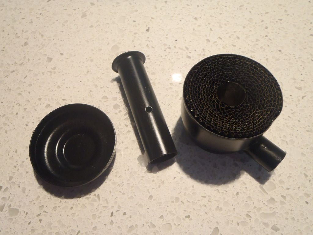

I had mine powdercoated while the engine was apart. Inside there's a brass sponge of some kind. I managed to flush mine out, and the heat from the powdercoating process finished the job. But an extra catch can of some sort would help a lot. Plenty out there from the usual performance sources.

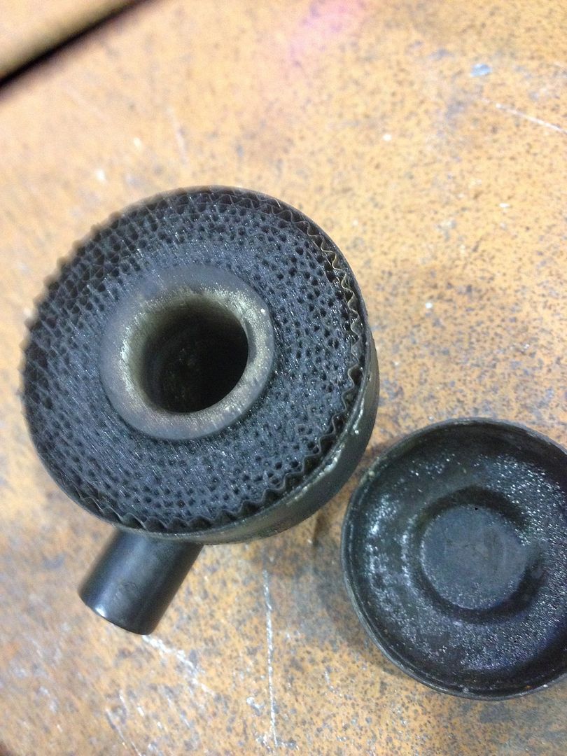

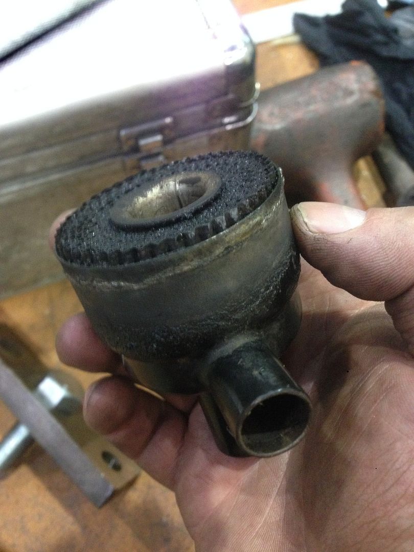

So, pulled the cap off today.
Here's some pictures...
Pretty ****ing blocked!
Oil vapour flows up the centre, down the outer ring of honeycomb brass then out the side tube. The honeycomb brass finishes at the pressed line above the outlet tube, so it's not very long.
Oil apparently collects on all the surface area of the brass. Liquefied oil trickles down the bottom to the bottom of the bulb and back into the engine through a single 3mm hole in the inlet.

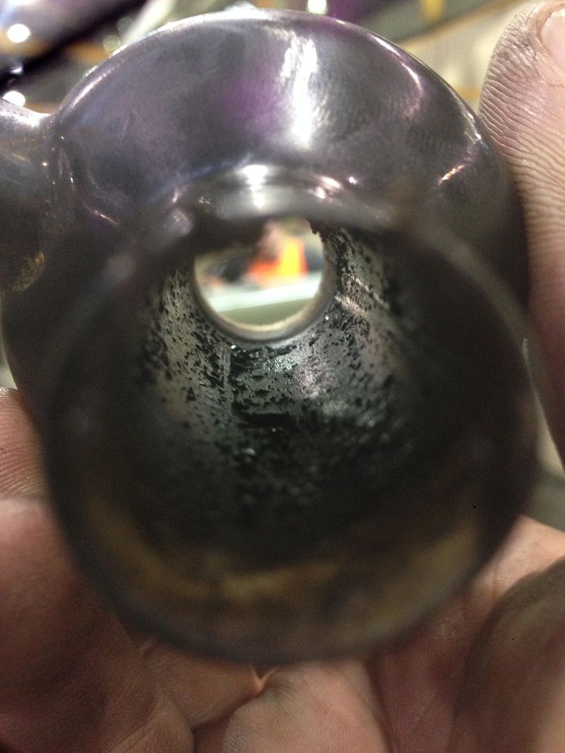

Here's a picture of that hole, should be able to see half way in along the bottom of the pipe.
So if you understand that all well enough, then you might catch on to the idea that even the fitted orientation of the separator matters somewhat. Since there is only one hole to drain oil back and it's mounted on an angle [with the head being on an angle].
If oil pools in the base I guess there is a chance it might slosh about and into the intake. By memory, factory fitted has the hole on the top side, 180 degrees out from ideal. But that's just mine, other might be assembled with the hold in another position in relation to the outlet?
A positive note here... Even if the honeycomb is blocked the hole might stay clear to stop a positive crank case pressure build up in the engine.
So since the whole thing is just soldered together, tomorrow I'll get the oxy back onto it and heat the tube/bulb joint and pull it right apart. Lay out the brass and clean it [it's just a roll of crimped brass sheet] and reassemble. If I destroy the brass stuff, I have a few ideas about machining something up to replace it.

Cleaned it out today. Parts washer at work is amazing... What ever fluid is in it destroys everything and dries off clean without residue so well you can paint straight over it. Would bang/10.
Sand blasted it afterwards and washed the hell out of it again and a primer undercoat to stop it rusting.
bronze has uncoiled a bit and the tube doesn't fit up the guts... I'll wind it back tight with a 'Eze-out' tomorrow.
