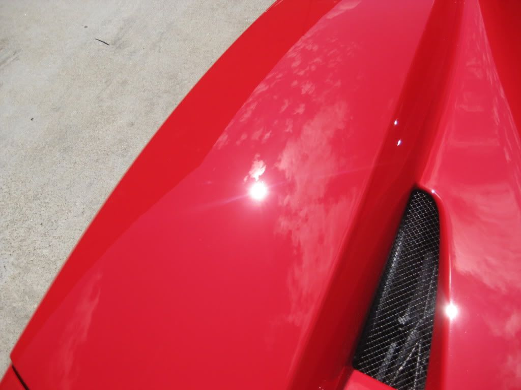

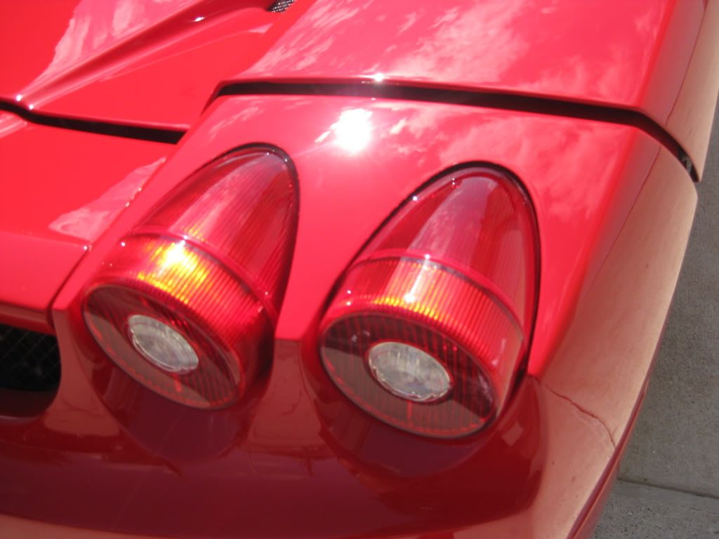

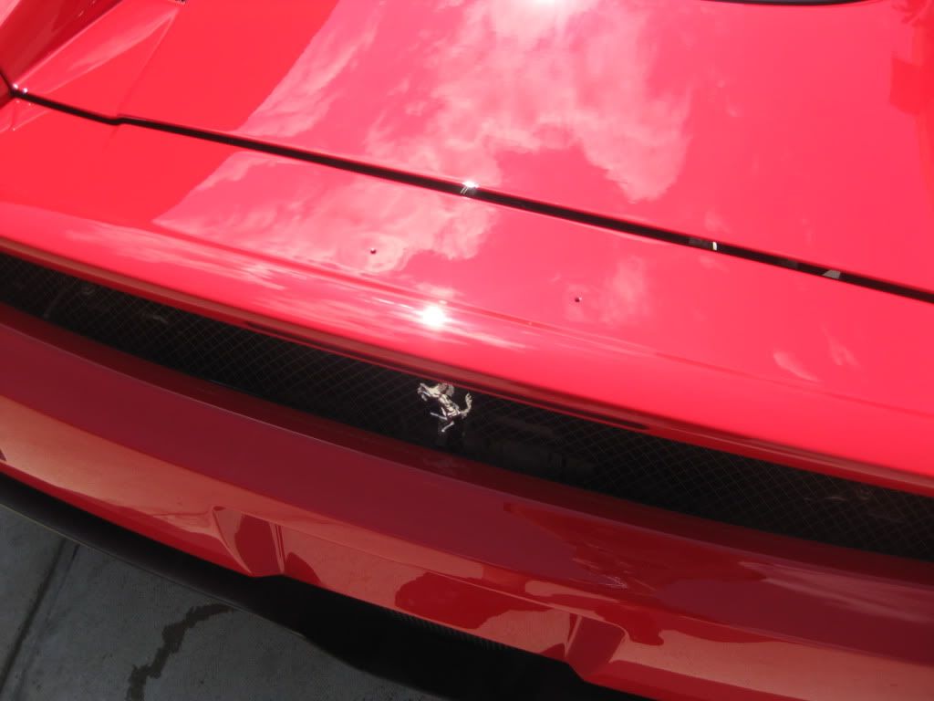

With 500 miles on the clock and this car having been washed less than a dozen time, paint reading were as expected. Moving on to inspection, we find the typical marring and defects commonly found in Ferraris - new and driven

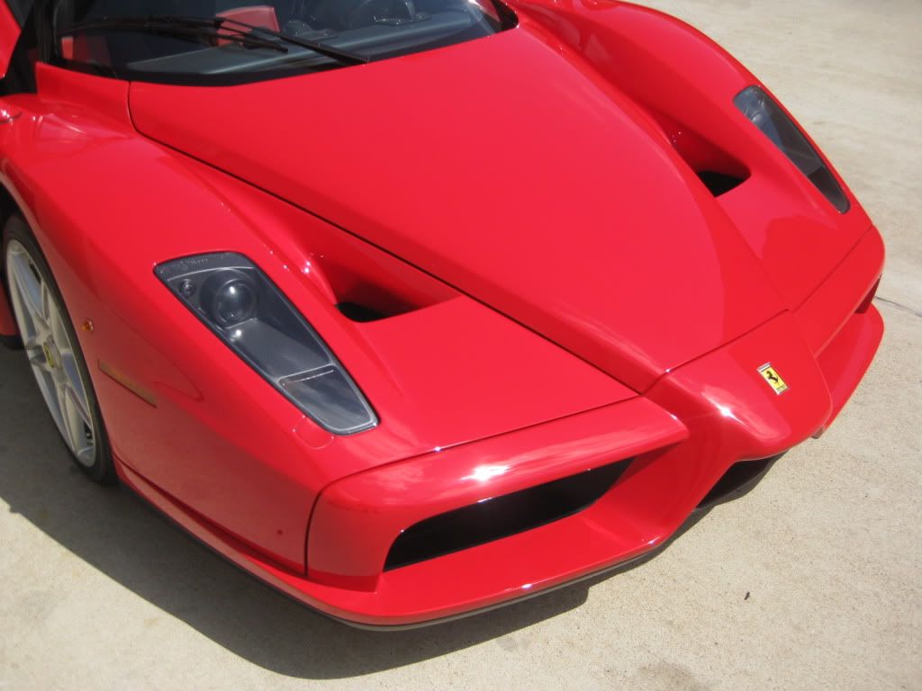

Few pics after correction and final wash, IPA wipedown and before beginning the four day process of application of sealant and carnauba protection
Clarity and depth of color restored
Four microns of clear coat removed produces a flawless finish
Hardware and lights removed to correct will be re-installed after last stage protection is applied and cured

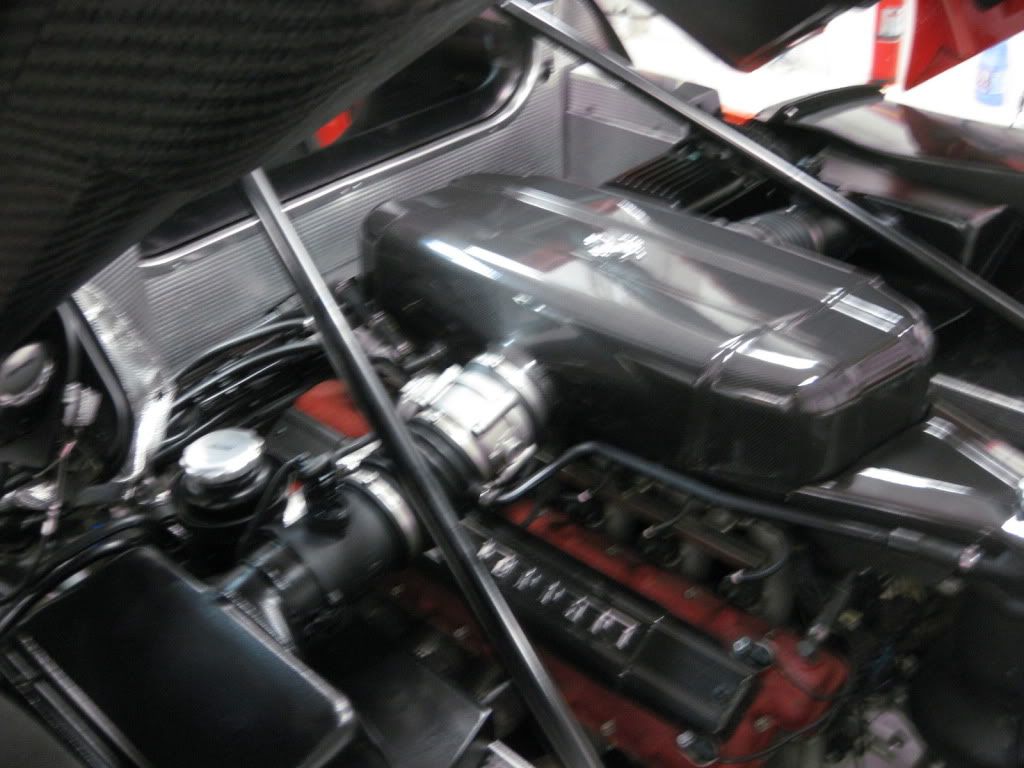

Engine bay cleaned with TAW, low pressure washer, various brushes then dried, dressed, polished and sealed
