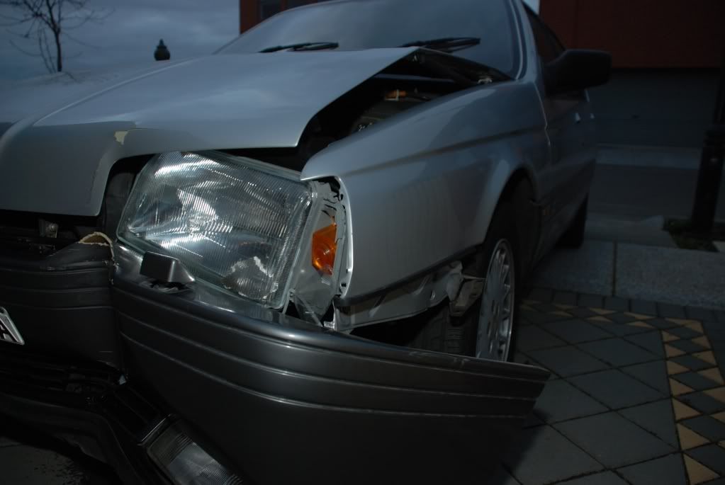

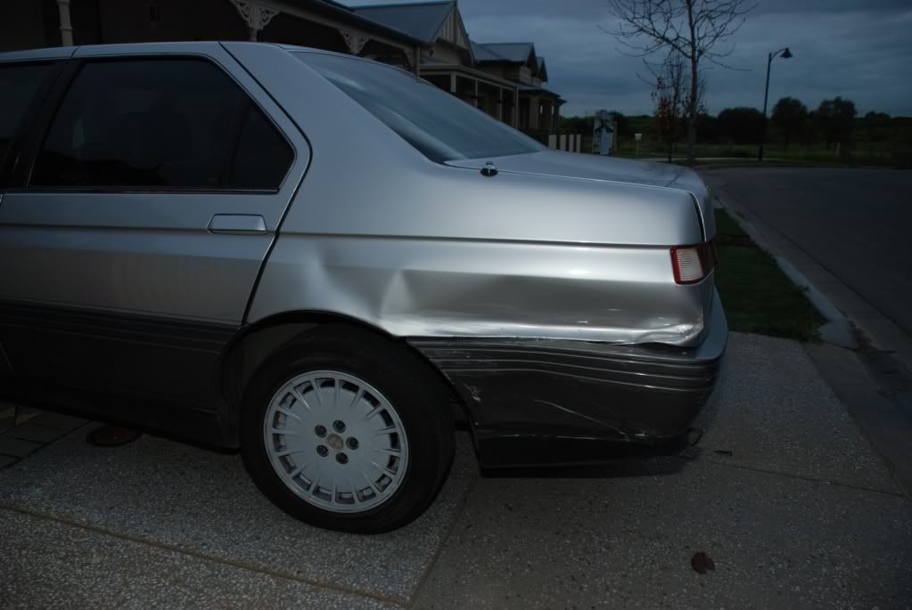

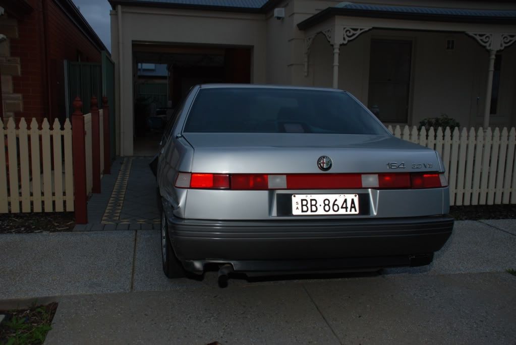

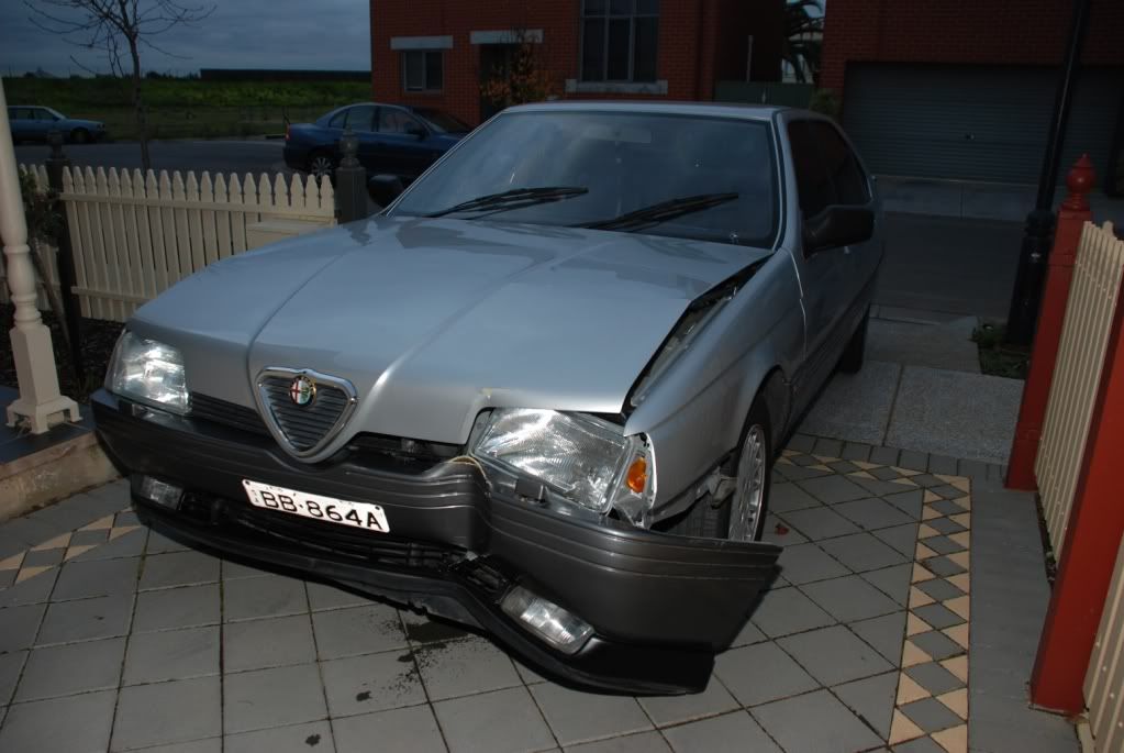

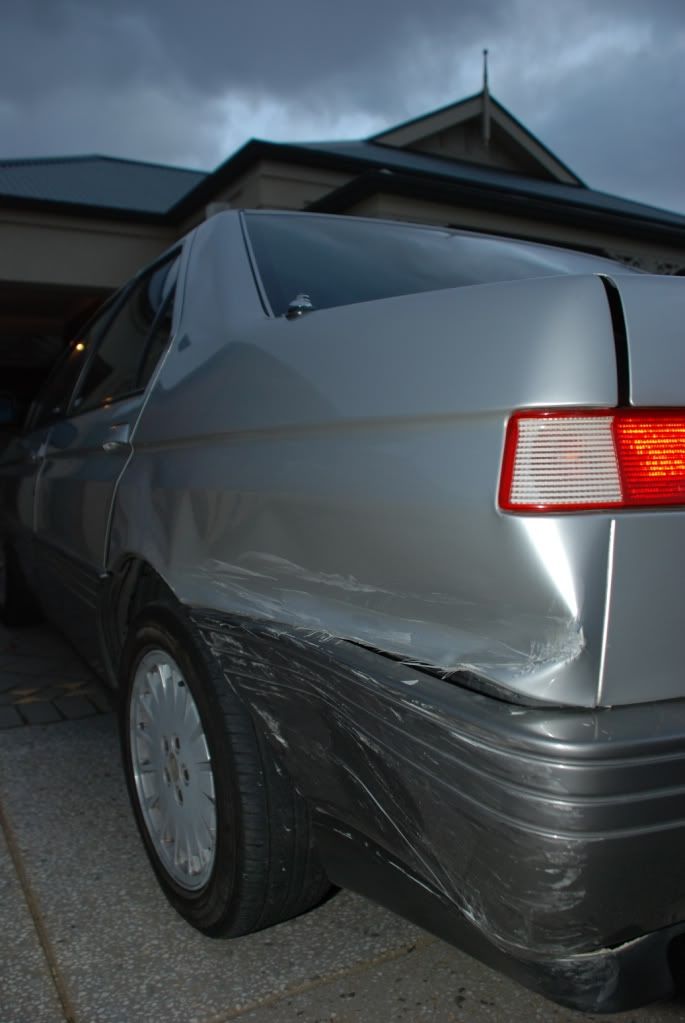

After an accident with our 164 in May, the hassle with dealing with someone else's insurance company and an extended time to source parts and get the repairs finished, we have had a month of motoring in what I thought was the best 164 in South Australia. I took the opportunity to have further work done including repainting the roof and fitting new headlights while the car was off the road.
Just yesterday, on the same f$%king intersection almost 2 months to the day, a person went straight through on a red light hitting our 164 on the side, spinning the car 180 degrees and into a traffic light smashing the front end. Thankfully my wife and son are ok and we are insured, but I suspect it will be borderline to have repaired.

I'm sorry to see that happen! It looks like a really nice car. I don't think the rear damage is too bad, really. I'm looking at the panel seams.
How about a side view of the front damage, both left and right?
Is the other party liable?
Just looked at the photos again. That's a beautiful car. Don't panic!
3,719 Posts
You will be surprised at how superficial that damage is. The things that write off an old car are the A, B and C pillars. If any of those gets bent then it is cut and weld and that is expensive.
Granted the front and rear damage together will be a fair sum but at least there is no structural damage.

The initial feedback from the repairer is not good, however the insurance assessment hasn't gone through yet. The front I'm not worried about. Headlight, bonnet, radiator, condenser and headlight can all be sourced. I have a (partial) spare car and can cut the front metal section behind the bumper which can be welded in, repainted etc.
The rear however is the biggest concern. It looks like the entire backend has moved a bit which means it needs to go on the chassis table jig - the rear quarter panel will need to be cut out. The spare car also has this, mint - and I can cut it out and hand it over to the repairer to save some cost.

Well I just got back from the repairer and had an extensive look at the damage. The rear is not anywhere near as bad as I originally thought. Rear suspension arm has bent and the pick points are still spot on. I can have another quarter panel grafted on, while a complex job, is certainly feasible.
The front is more worrying. The impact on the post has caused the top cross member to be pushed in which has in turn caused the inner part of the engine bay on the opposite side of the impact to be deformed. It may have also pushed the lower front crossmember - if that has happened then it is starting to look like an engine out job to repair. The repairer will put the car on the rig and pull out the top cross member, but it is questionable if the engine bay panel will deform back to its correct shape. Both headlights are stuffed, the strain from the impact warped the headlight assembly on the driver's side and caused the glass to crack... $900 of recently purchased lights are now fit for the bin...
