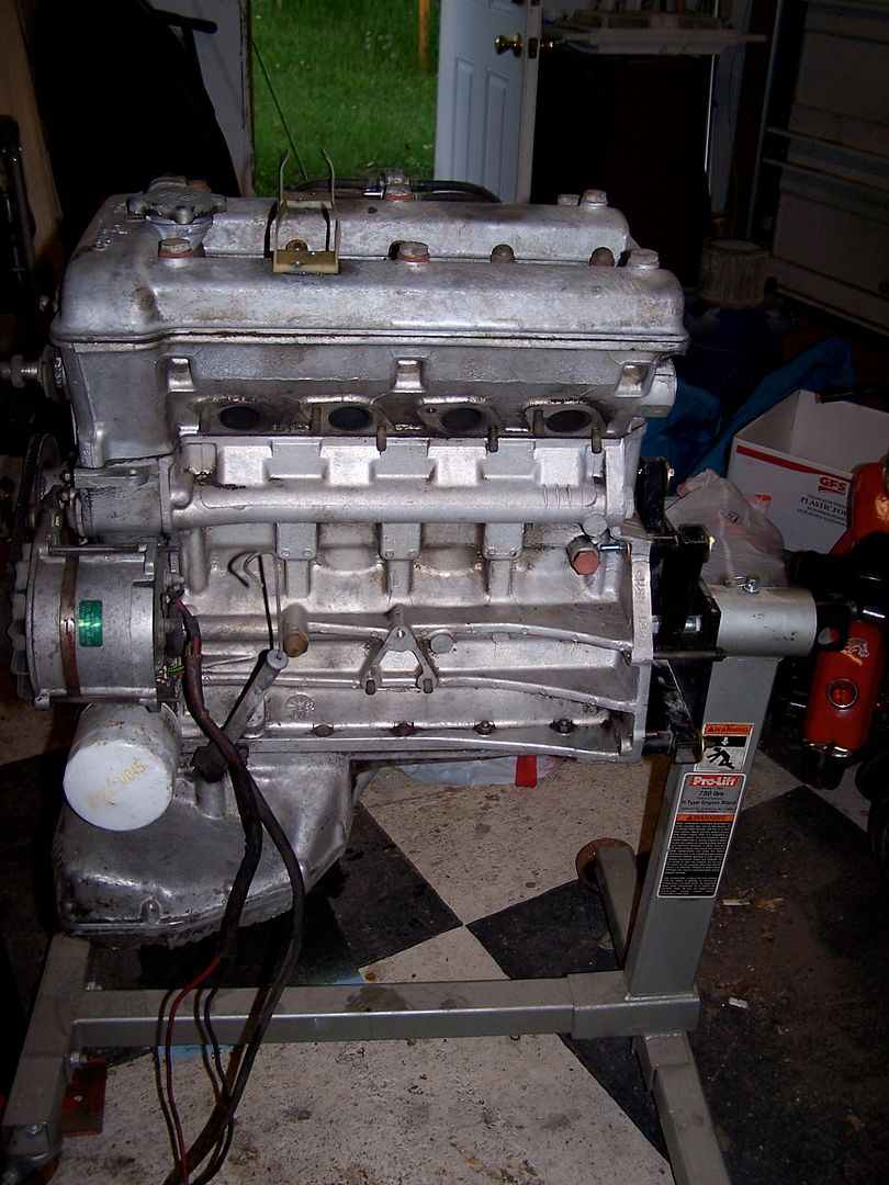

I have seen many topics regarding this. Please let me know your thoughts. The stand has held an inline 6 4.0L for years so it's not the stand that scares me. It's the size of the transmission mounting bolts that I wonder about. They seem long and thin for this duty.
I used the upper mounts with new bolts, grade 8, and the bottom studs which are attached to the engine.

I've always mounted Alfa engines from the exhaust side engine mount; never had any problems. I'd also be a little uncomfortable using the bell housing attaching points.

I agree with Monsai and I would be most concerned about breaking the 'ears' off the block. One of the Alfa shops (I forget who, now) used to sell an adapter to support the engine on the engine mount boss. They were kind enough to post a pdf diagram after they ceased production...

I prefer the side mount as the motor rotates so much easier and you can attatch the flywheel and clutch with the motor on the stand.

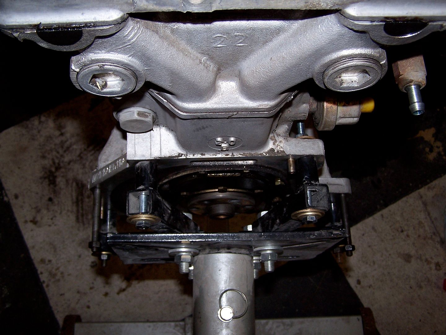

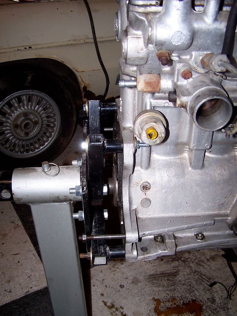

Here are a couple of shots of the simple adapter I made for my cheap Harbor Freight engine stand. It's made from a piece of 5" x 5" x 1/4" box section that I got from the local metal supply company that I cut to about 6.25" and drilled the matching holes. Cost was only a couple of dollars, and took about 1/2 hour to make with an angle grinder with a cut-off disk, and electric hand drill.

I personally prefer to have two side mounts, is easier to rotate the engine in any position, and no strain is introduced in the engine block skirt, also it allows for the installation of the flywheel and clutch.

And as far as engine stands go, I just transfer the motor mount pattern ( or in the case of the `1750, I include the oil filter stud) to the harbor freight mounting plate directly - no need for an adapter (however the adapter does provide for a full range of rotation).

No photo sorry but I too have a home made 2 post stand which I made at home over a couple of weekends, in my case some 20 years ago. Takes both 4 and 6 cylinder Alfa engines and always on loan to someone it seems.
I'd not be comfortable at all using the rear face given the weight of the engine and the relatively thin casting there. It's not like a bell housing which is a machined fit.
