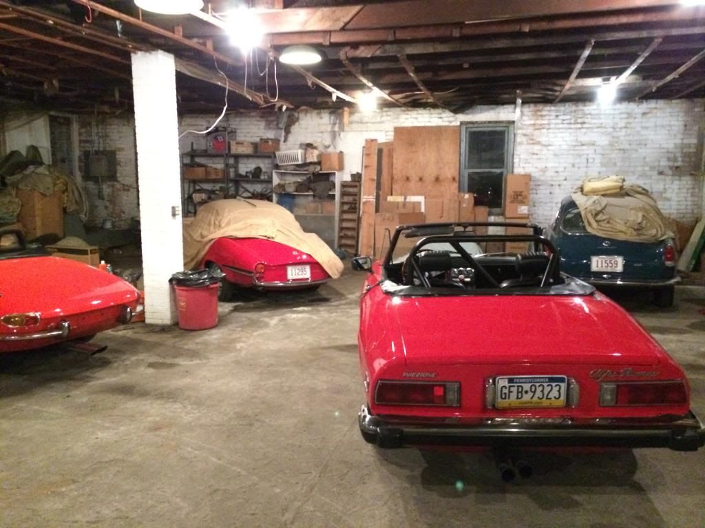

It's stable mates. Well, it can join them once it's a little more respectable haha
