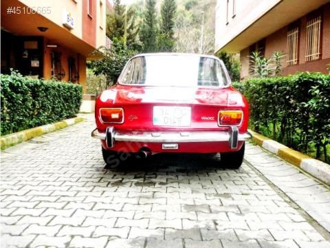

Hi everyone. I recently found this ad online listing the car below. I plan on driving over and checking it out in person, but a couple things seem odd to me, and I would appreciate some help identifying.
I talked with the owner on the phone and he told me that this was a 1967 1750 GT Veloce.

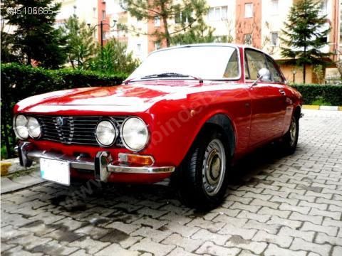

From what I know, the grill present on the car was only featured on the 2000 GTV's and later the GT Juniors. The turn signals are also from those of a 2000 GTV and the Giulia GT 1600 Jr's... and so is the front bumper wıth the rubber guards.

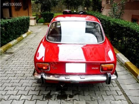

The rear end however features the Veloce emblem with the smaller taillights...
When asked about my confusion with the grill, the owner told me that this was the Junior version which was ''between the 1750 and the 2000'' didn't quite understand that well...
Any way to clarify this? Thanks!
Edit: btw this car is in Europe (so certain specs would be different than US models i believe)
931 Posts

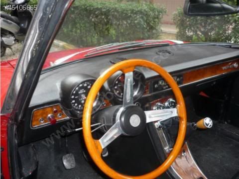

It's a 1750 GTV 2nd series (thus NOT a 1967), with a non original 2000 GTV grille (which fits without modification). The Veloce at the rear isn't original neither, nor is the gear knob. All other visible details fit the 1750 GTV 2nd.
The best thing to do is to ask for the type on the chassis plate (which should read 105.44), and chassis number that could be checked in the Fusi pages to be found on the site here or submitted to Alfa Romeo archivio storico.

It's a 1750 GTV 2nd series (thus NOT a 1967),...
I agree; it appears to be a Series 2 1750 (1970-1972) with a 2l grille. OTOH, it may also be a Series 4 GT Junior with a 1750 interior or a Series 1 1750 with a hanging pedal conversion, 2l grille and a Series 2 1750 dash and bumpers. Knowing the chassis number, located on the right side of the bulkhead, would be quite helpful.
