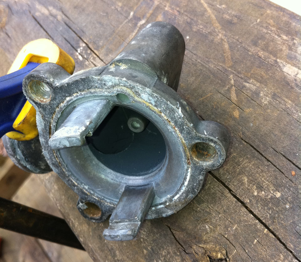

The stock housing has two "ears" that need to be removed to fit the new thermostat. Here is the stock housing:
First I ground off the two ears with my Dremel (I don't have fancy air tools and such):

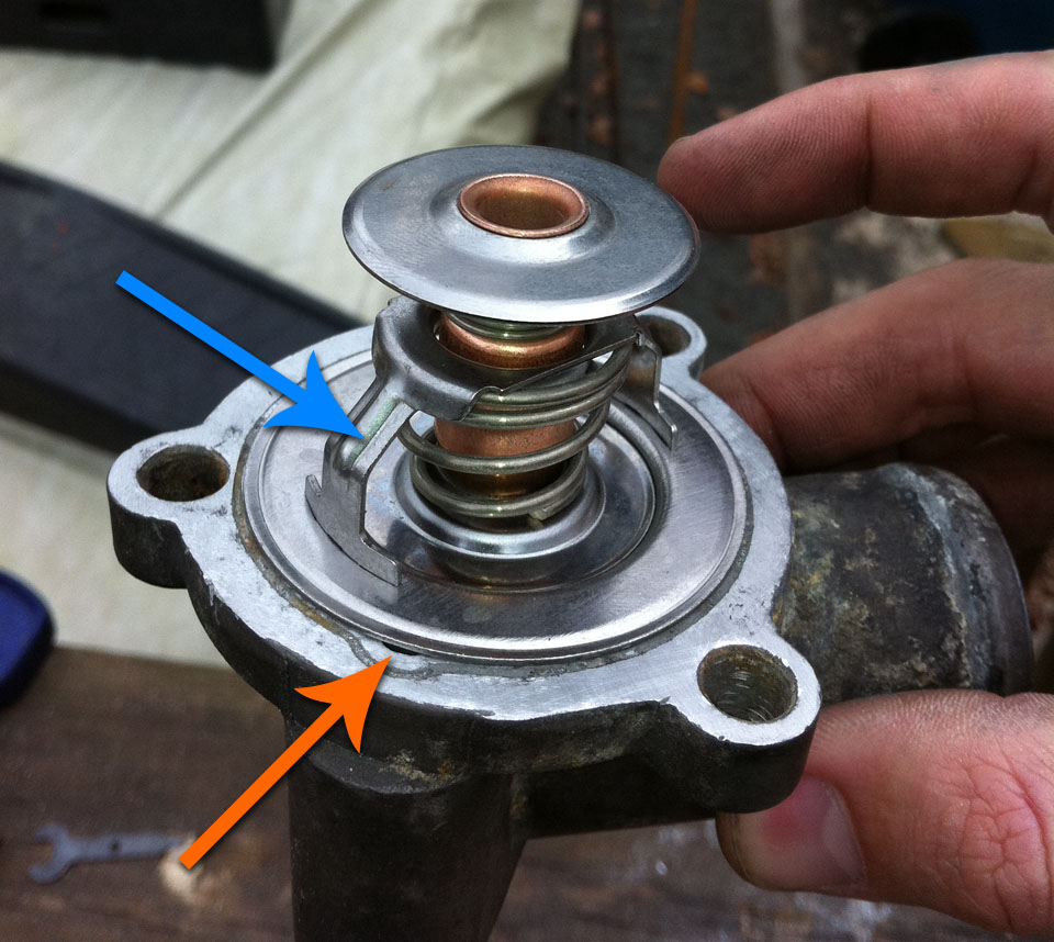

Here is the new thermostat sitting in place:
Now, for the important part so y'all don't have to run to Autozone and buy a second T-stat like I did. You need to drill a small hole in the perimeter so the water can flow through to the bleed screw (orange arrow above). However, you can't just drill it anywhere as the "wings" on the new thermostat (blue arrow above) will only fit into the housing in a few different orientations, because of the trio of water temperature sensors. Hence, test fit everything together so it fits, then send a small drill bit or other marking tool down the bleed screw opening so you know where to drill/grind a small cutout for the bleed screw (I think grind is easier since its hard to drill a hole that close to the edge).
Here is my finished install (don't use this a guide for notch orientation, as I think this is from my first attempt where I ground the notch in an arbitrary place).
Reassembling the housing
Once everything is lined up (I stuck a piece of wire through the bleed screw cutout to keep it from rotating) you can reattach everything. Since I'm impatient and didn't want to wait for a new gasket, I just used the thermostat gasket maker goop. Big gotcha here: The thermostat sits slightly proud of the housing, as you can see in the above pictures. Without a gasket, the upper housing bolt holes can crack (they are thin small castings) if you tighten it too much, so tighten it just enough to seal. Then just refill with coolant, drive and enjoy!
