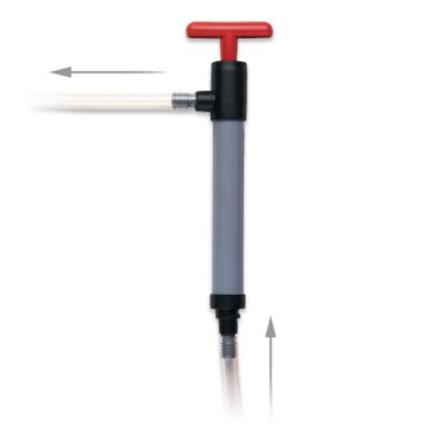

Beyond advising you not to smoke while working on it, no, there's nothing exotic about pulling a tank. It would be good to remove as much of the old gas as possible - pull out the sending unit, stick a hose down there, and either siphon, or pump out the old fuel (using an electric shop vac - not a good idea). Here's what I use:
It comes from Griot's Garage.
