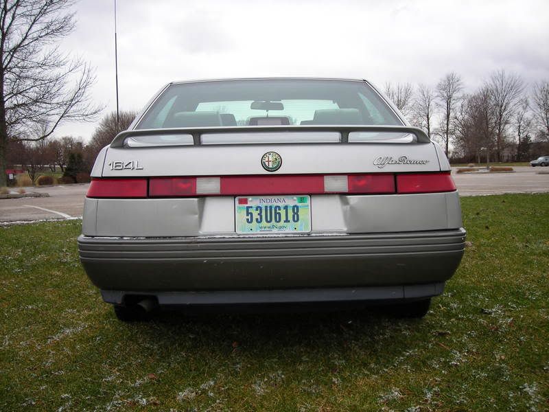

For sale is my Alfa. I had this car for a year. I really loved it a lot.
It has all new belts, new oil pump, new fuel pump, new tensioner pulley, tires are 80%, I have just replaced oil pan. When I was changing oil pen I have noticed that oil is mixed with coolant. As far as I know it would need head gasket to be replaced. It drives very good, though. It looks absolutely great. There is a new pain job 2 years ago. 67000 on the clock. Car has clean title and never been to accident before. I will give it away for $1000. I am in Bloomington, IN. I am very sorry to sell this car, but I am a student and do not have time to fix the gasket.
