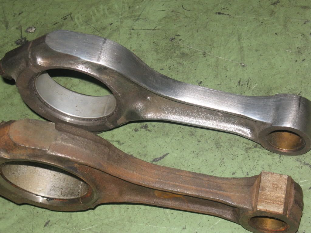

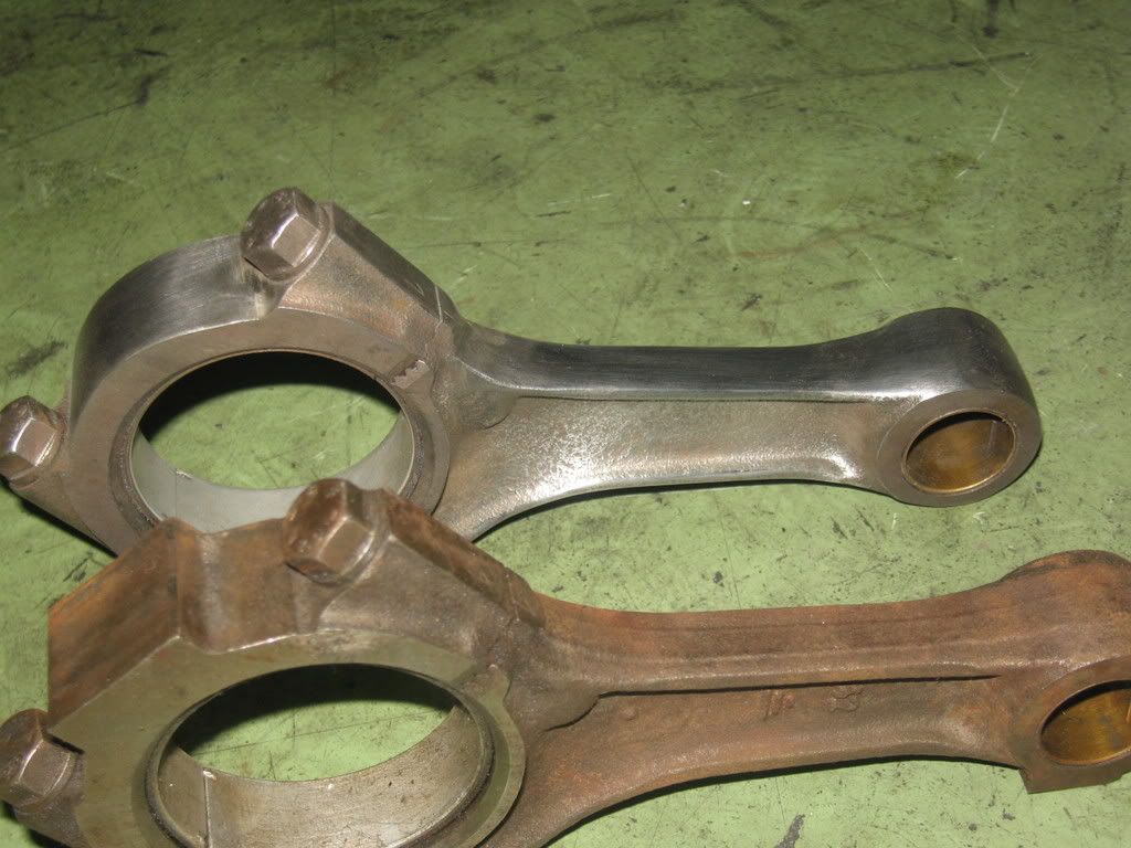

Here are my con-rods. 67g off each, mainly from the counter weights and top bottom balanced. Considering shot-peening but will go without if too expensive.

HHMMM i was just thinking about doing this to mine too as im really close to the build process on the sud, any info would be sweet:D
51 Posts
This is exactly what I want to do to my conrods, did you end up having any reliability issues? I have heard that they have to be shotpeened after polishing or they will be weak.
