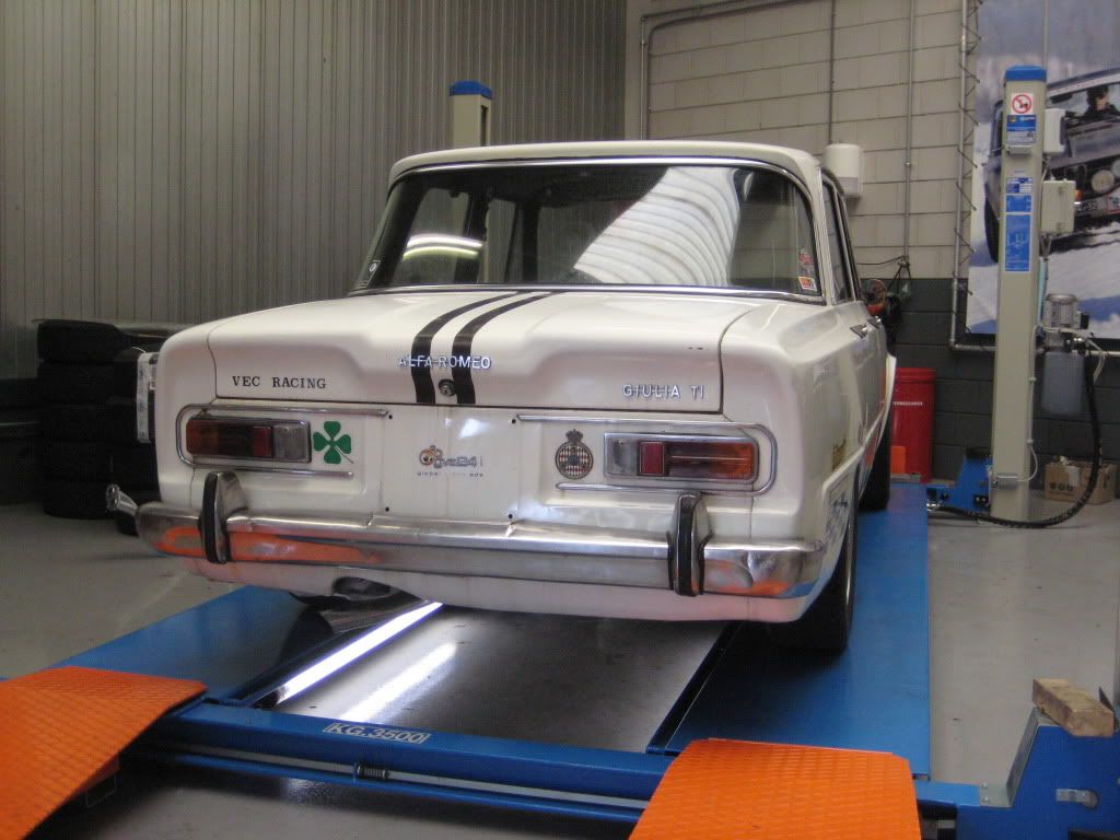

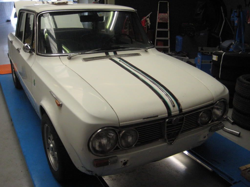

Well, here goed another. Save for the Giulia Station from Robtechno, I also have a very early Giulia TI, floorshift car.
I;m very sure Rob will tell about all the plans he has for this car. It's an original Monaco car, used in sprints and hillclimbs back in period. Then went to France and from there to Switzerland where he uncovered it.
It has totally cool springs, shocks and a modification to the gearbox for short shifting.
Also it was converted to hydraulic clutch use by way of another brake master cilinder. Has period sport seats, and lots of other goodies.

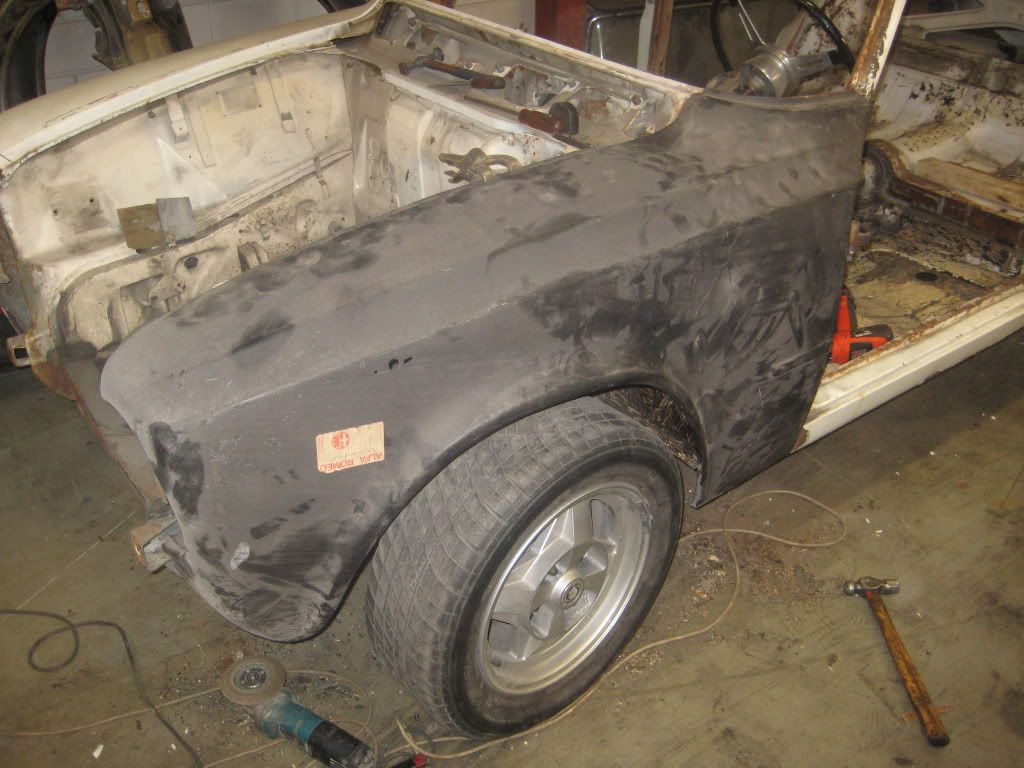

I'd love to see pics without the guards on. We had to fabricate quite a bit of the inner panel behind my rear guard.

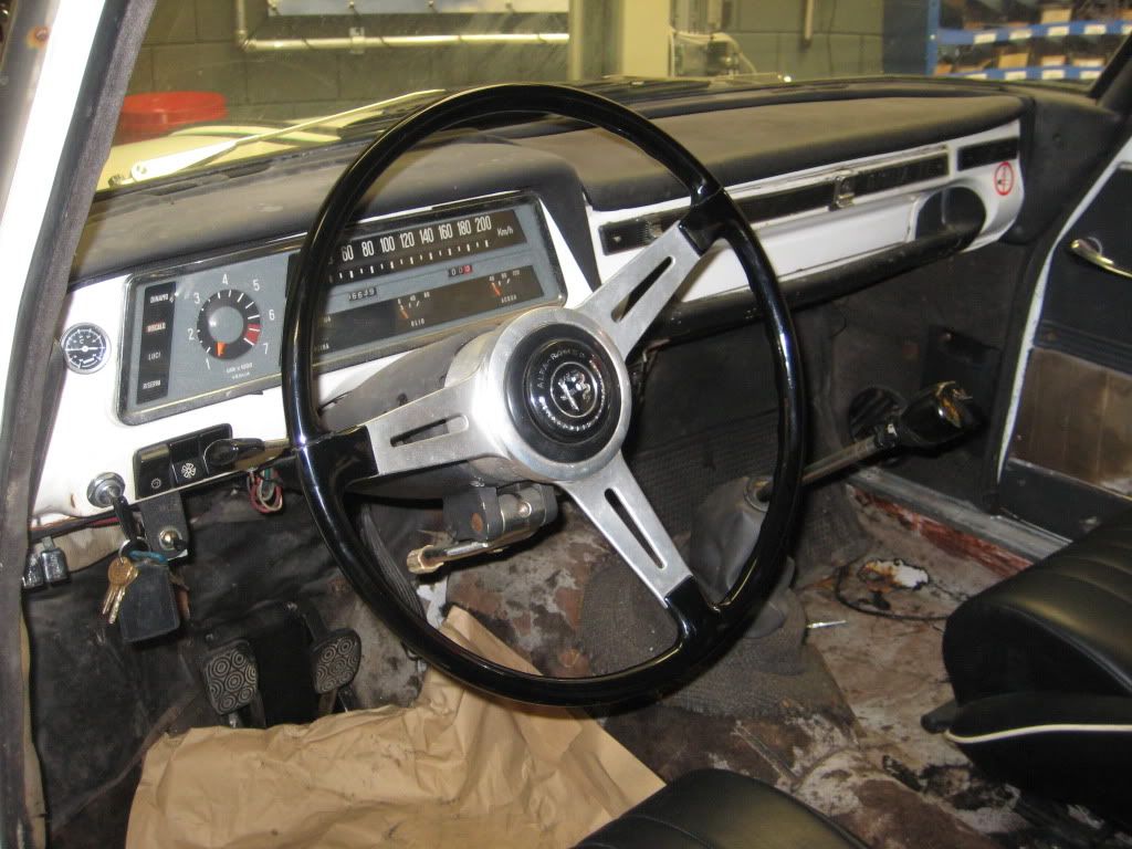

Great project, guys! And NOS body panels - - - wow. Rik, what is the little round gage to the left of the speedometer? Are you going to keep the ribbon speedo or are you going to put in TI Super style instruments?
1,533 Posts
Discussion Starter · #11 ·
The little round instrument is, what else? the tachometer. it's an Alfa, right?
We are going to install TI Super type instruments, I have a panel from a 2000 sprint here. Those meters are almost a 100% copy of TI Super.

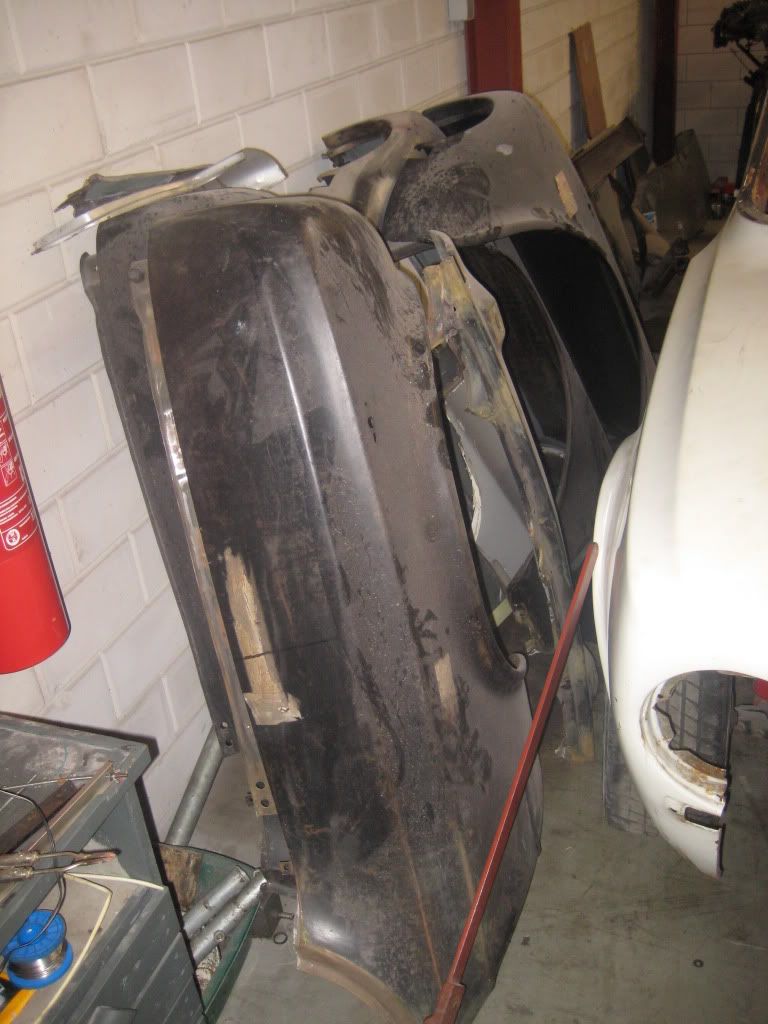

As to new panels, contact robtechno if you're interested in two new front wings, as I have 4. I trial fitted one and it's of course a perfect fit as the car never had major damage or anything.

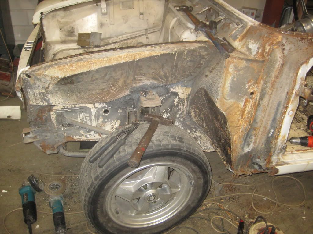

Great to see with the skin off. It really shows you where these cars develop rust from the inside out. NOS panels would be a dream!

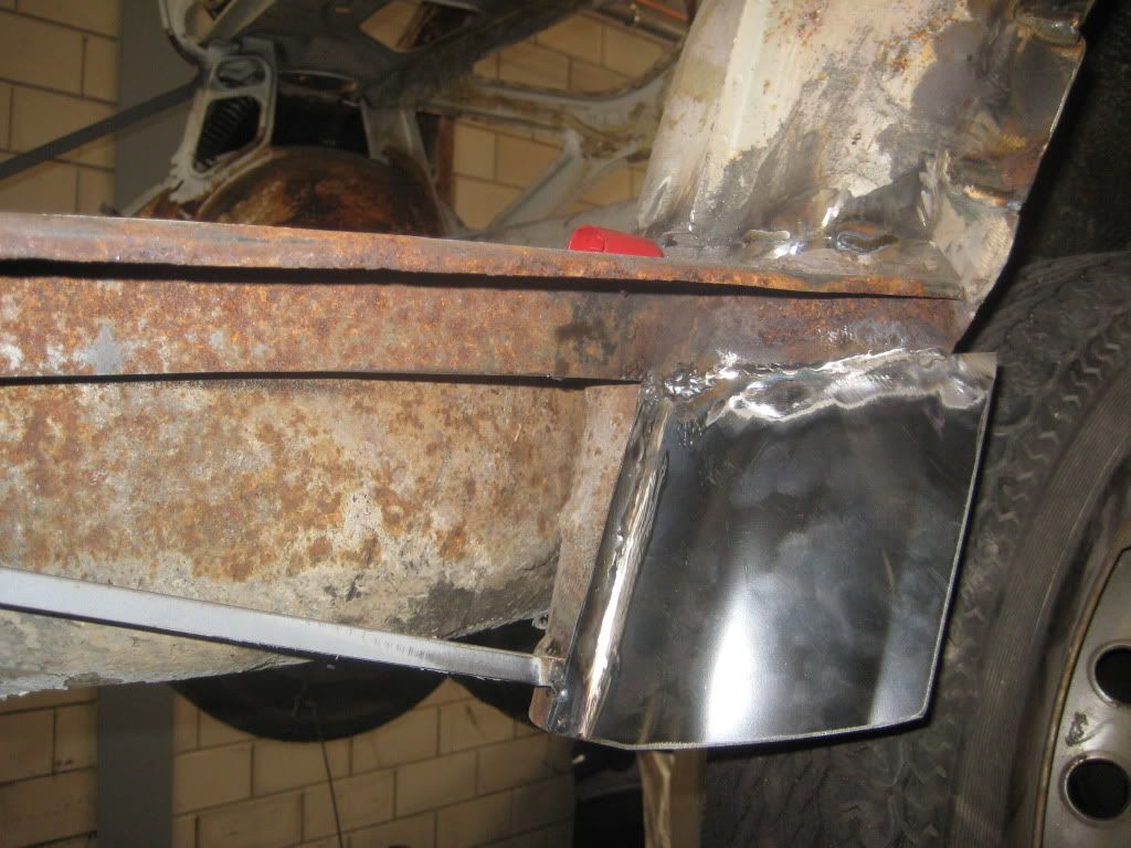

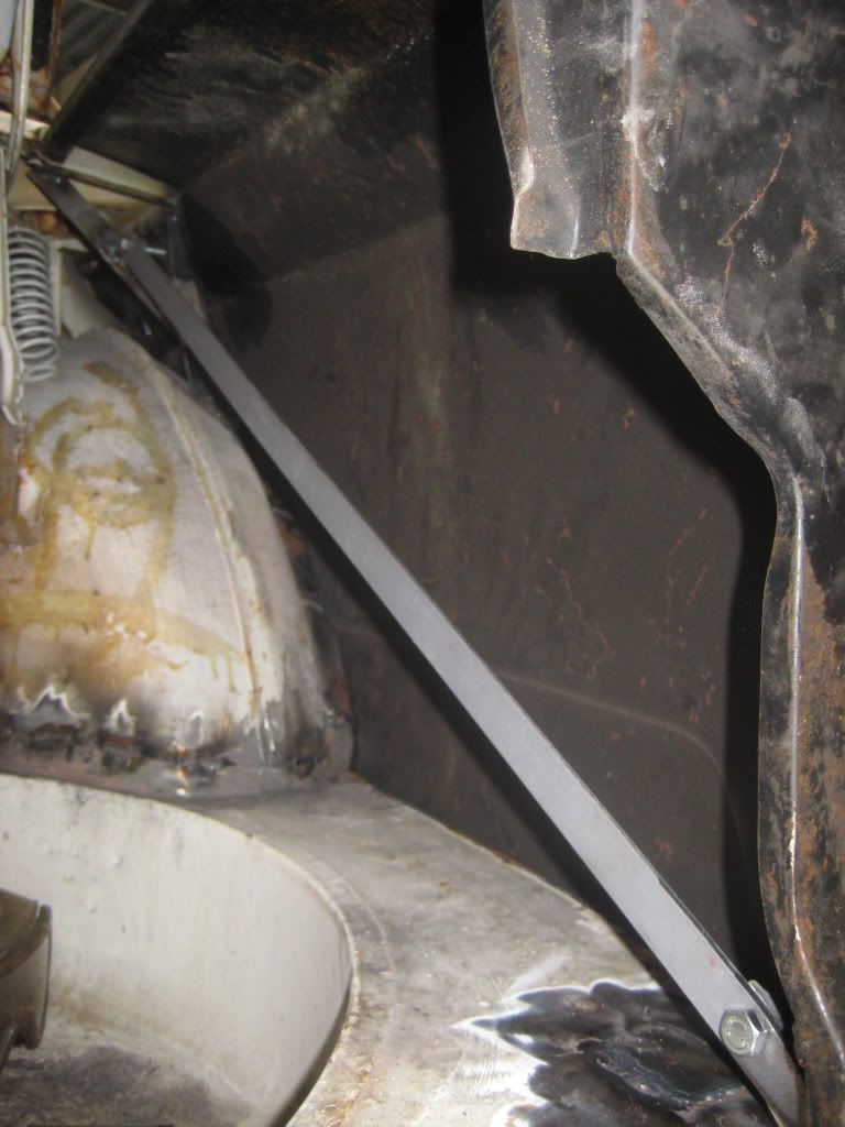

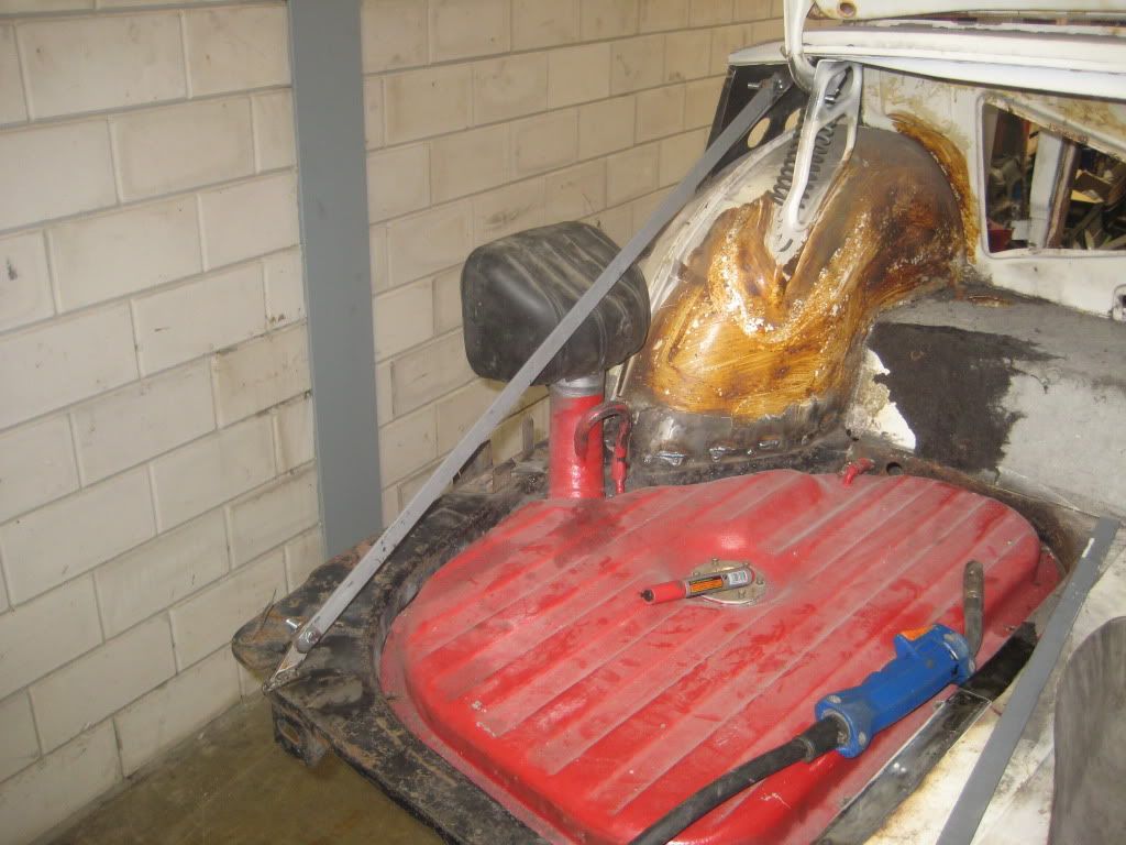

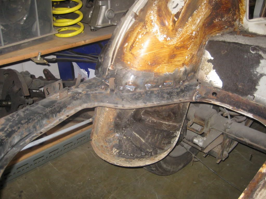

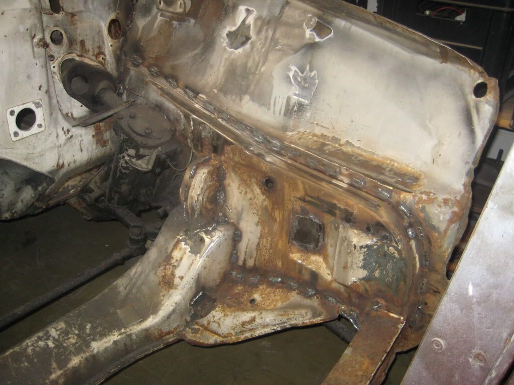

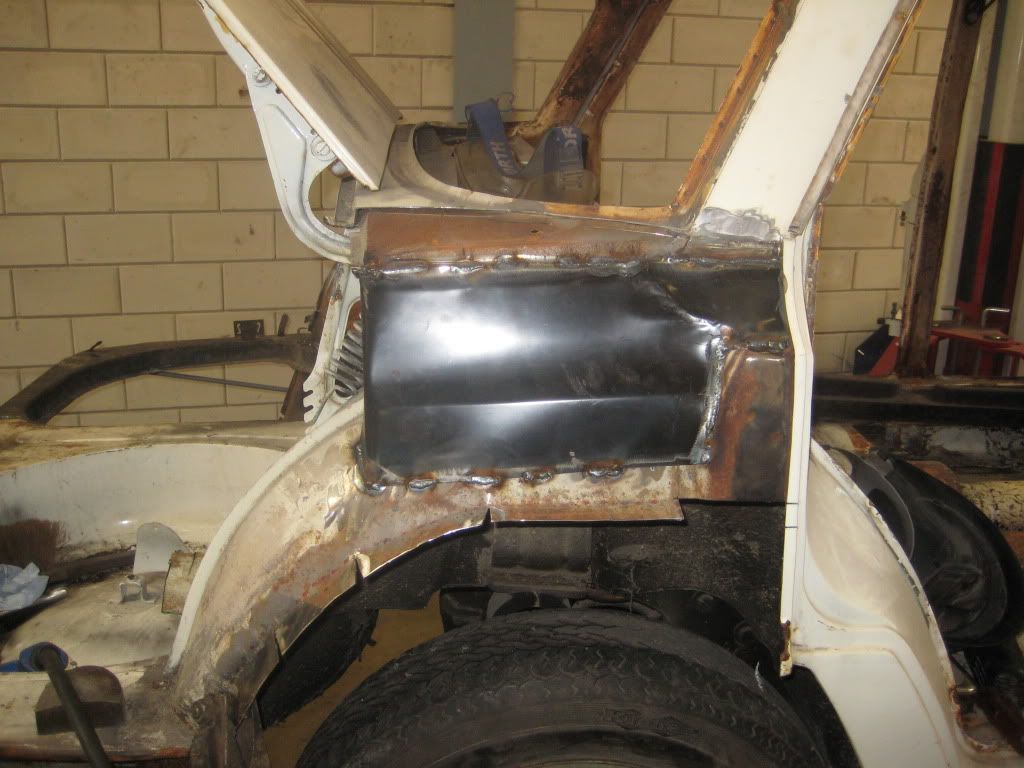

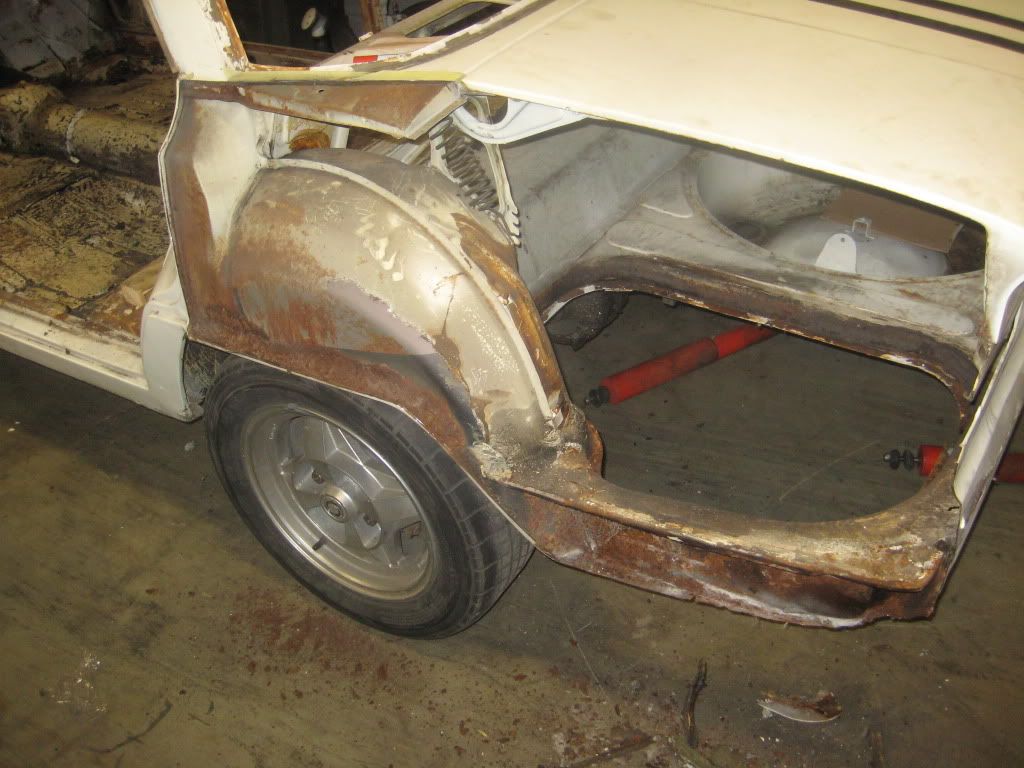

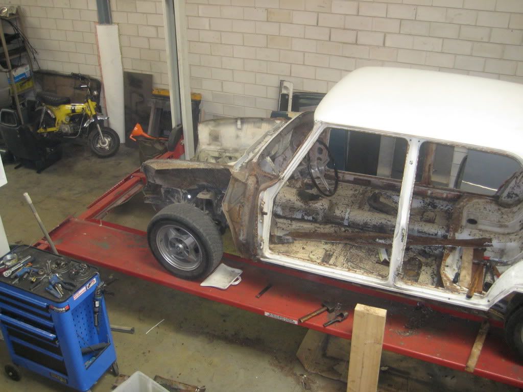

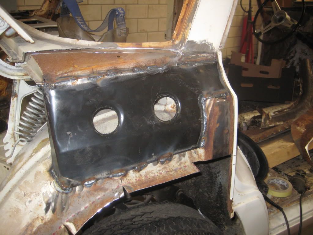

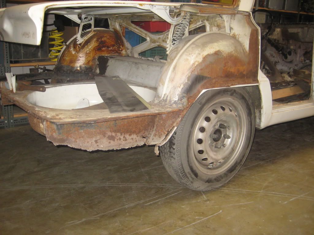

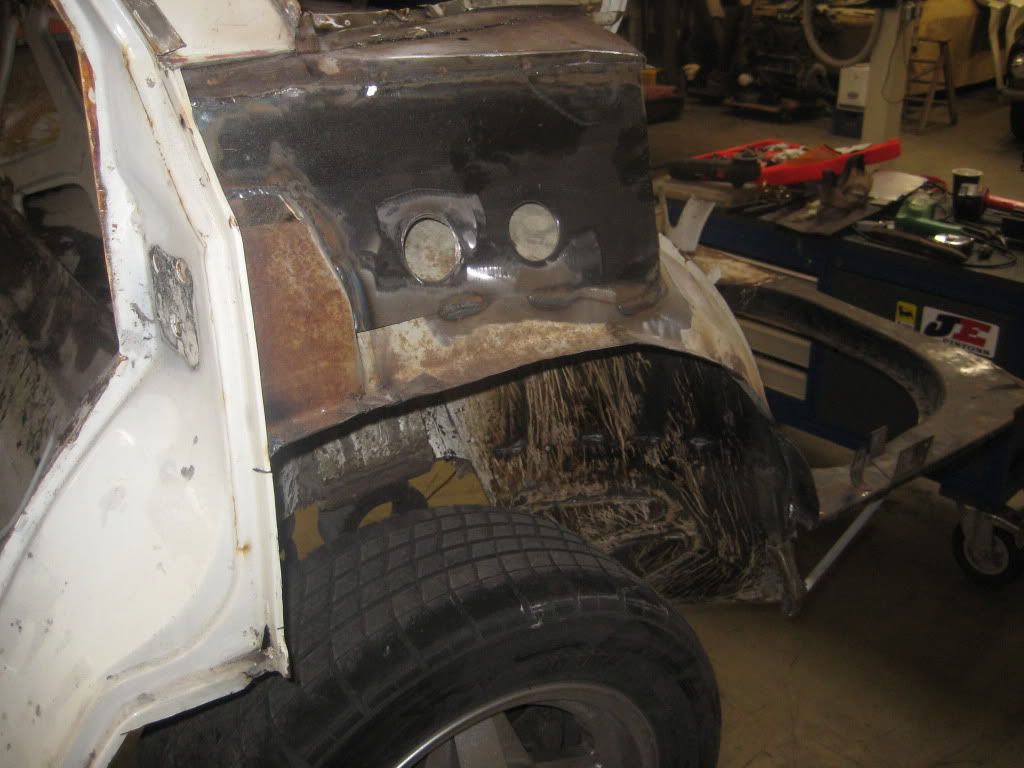

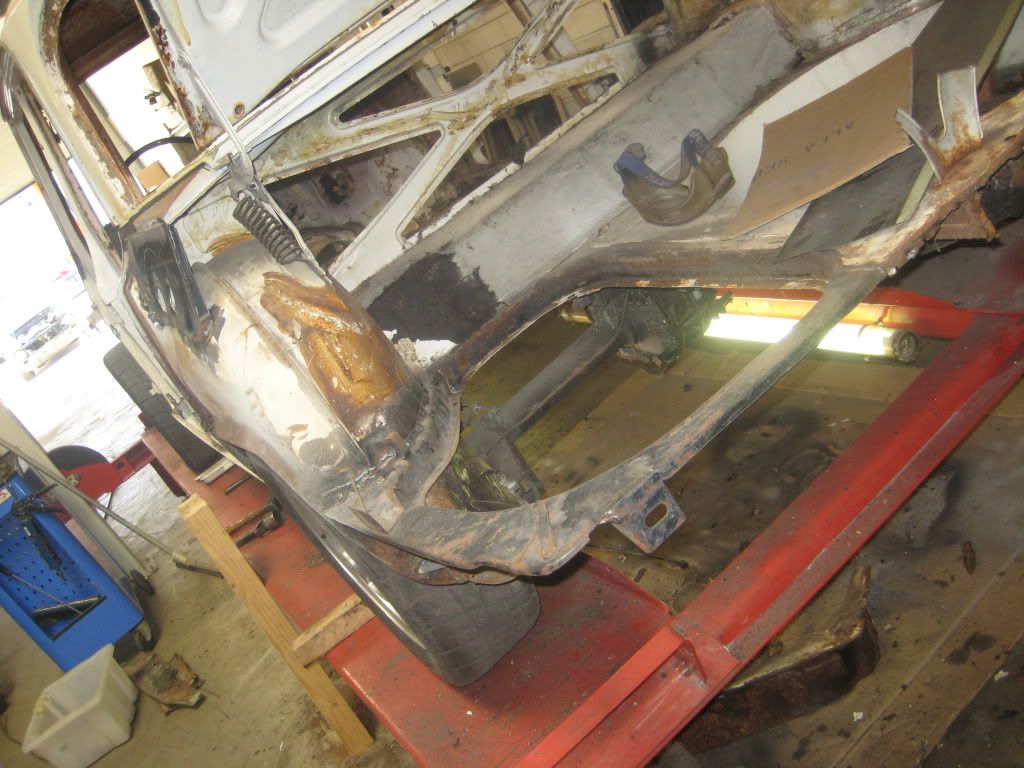

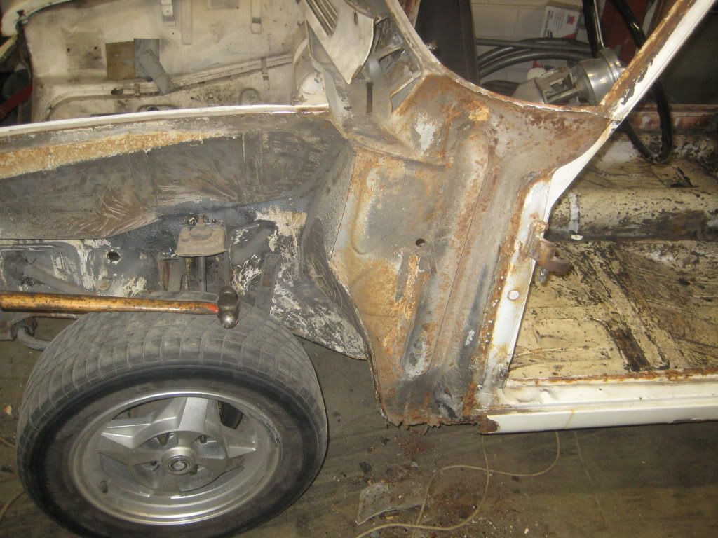

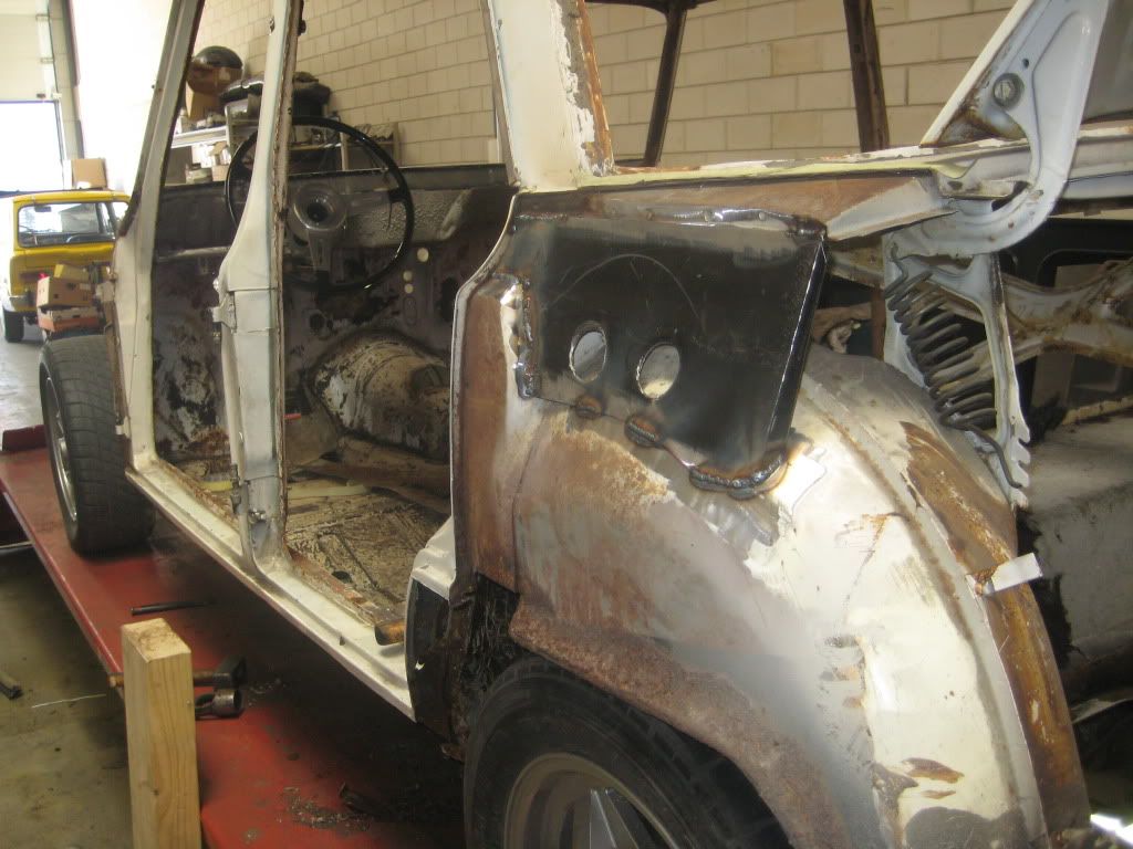

So, as the car is planned for shotblasting sometime next week when those guys are back from holiday, I've got some work in.
I'll be doing some welding ahead of blasting, because I want those parts back in Epoxy primer too.
So in goes a new trunk floor, WITH strengthening, because I'll delete the panel behind the rear fender and between the tank. This is always a known mud trap, with blocked water outlets. Also, the bumper support is only fixed to the floor and to nothing else. I can now just plop in a tank with fuel in it, and the trunk floor will be straight. No sagging.
The panels above the wheelwells: To strenghten the back end, because I will modify the wheelwells, to be exact, the OUTER INNER wheelwell, so as to be able to fit large wheels and tires, yet maintain stock appearance, and to delete another big rust trap on a Giulia. I'll roll the fender lip, delete the outer inner fender, and make a custom panel above the wheelwell , which will give more than 2 cm extra space for a wider wheel. I did this on my own Berlina and can run a 7x15 ET25 wheel on my lowered car, without problems.
I'll also be welding lots of other small areas before blasting, and then, when it gets back, I'll start on fitting new panels.
Note that I left a small lip of the rear fender intact. This is for fitting, otherwise I'd be lost about where to start fitment. Now I can fit a rear door, hang it straight, then fit a front door, then I can start on the front fender. This way, all my measurements will add up. I'll repair the inner sill, and weld it up solid. After that I can weld in a new outer sill as per original yet it will be far stiffer. But it won't show on the outside.
Pics later today!
Rik
