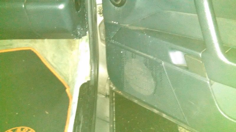

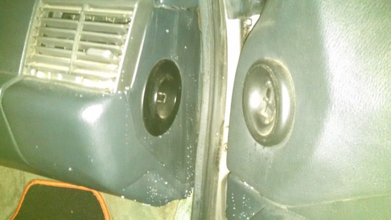

Landed back in Seattle after being in Cali for the weekend. Walk up to my car, and I see its got fogged up windows along with droplets from the previous rainfall. I open it and I see the tell tale signs. I gotta fix this ASAP. My mechanic in LA cleared the Sunroof drains, so the leak that ruined my sunroof motor was fixed, and I didnt realize that I actually had 2 leaks. I've been here in Seattle for over a month with several weeks of rainfall and no leak, but today, different story. here are some pics.
Theres a seal that kind of acts like a rain gutter/rail at the top of the door frame and noticed it was gunked up so I cleaned all of the dirt that was in there, Mind you I just got back from LA and its 0150hrs. What do you guys think?:helpsmilie:

What's the headliner like? Is it wet up there anywhere? Alpaca Mike has a leak in his non sun roof car in the same area. We're thinking it's in the corner of the windshield, but nit sure.
