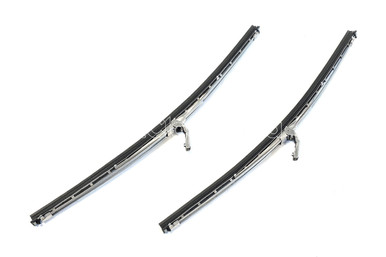

Hi all,
I have a 75 Spider and would like to put chrome wiper blades
Hand Green Finger Gesture Thumb
Hand Gesture Insect Finger Thumb
Finger Gesture Automotive tire Thumb Pliers
Would these fit?
Thanks!!

A low cost pair of stainless wiper blades would be Trico Classic 33-150 - available for less than $10 each.

The bay link in post 2 above is for 13 inch blades. These are much shorter than what is used on any post 1970 Alfa I've seen over the years. Classic Alfa has these in 16 inch, which is the size you want for a GTV or an S2 Spider. Originally they only had the 13 inch and I ordered a set without noticing. Ended up giving them to a Duetto owner.

Yeah sorry, it was meant to be a generic link rather than specific - I'll remove it - here's the correct one or you could pay 286 quid for a genuine pair of Maserati ones o_O
Alfa Romeo Alfasud Alfetta Original Wiper Blade Carello 16" 41cm - Fiat Lancia ? | eBay

Classic Alfa believes all GTVs should have 13 inch wipers. I saw a Sprint GT with this recently - it works, but the wiped area is a lot smaller. Adjusting 16 inch wipers to clear each other on a GTV is somewhat of a challenge, but feasible. 16 inch works perfectly on S2-3-4 Spiders.
I wonder if the US safety regulations had any effect on this. They are the reason all wiper arms and wiper blade frames were black from 1975 or 1976 on - to reduce glare in the windshield.
