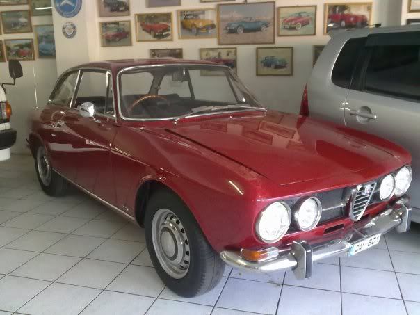

My reason for posting here is that I have been tempted to purchase a 1972 Alfa Romeo Gt 1750. Now it may seem to be in excellent shape in the photo though it does suffer from a cracked dashboard, bump in the front bumper, three small dents on body, and both front running boards and oth rear wheel arches have been cut and welded again (due to rust). The paint is cracking in areas and rust is lifting the paint in other areas.
However the car is still in a very presentable state, despite having said the above.
My questions are:
What is the value of such a car in this condition?
Why doesn't it have side indicators?
Is there anything wrong from its appearance?
that's normal, no big deal
normal, normal again
NOT NORMAL! Before you do anything else, you need to determine how severe the rust is. From your description, it sounds like it could be pretty bad. When you say "running boards" do you mean rocker panels? The rockers are structural on a 105 Alfa.
The car may have negative value - i.e., it could cost more to fix its rust than the price of a car in better condition. Have an experienced restoration body shop assess the car before committing to purchase.
In what country was it first delivered? Perhaps they didn't have a requirement for side markers back in 1972
From one photo it is impossible to assess its appearance. The grille, bumper, and front fenders look OK. But I can't comment on the rest of the body, the interior, underhood, undercarriage, ......
I may be exagerating to a certain extent. Let me re-ohrase.
The front running boards (first 10 inches) have new plates welding in. The rear rear wheels (on the lower corners) have new plates welding in as well.
Apart from this, the body seems to be in perfect nick.
I hope I explained myself and the situation more clearly.
The Alfa has been made to be sold in Malta, a small island in the mediterranean. Hence, this is why it is RHD.
Is it really a 72? The 2000 came out in late 1971, and this looks like a 1750 to me, which would make it a 71 or earlier. The dash, grille, and wheels all look like 1750.
Shouldn't it have front marker lights on the fender sides?
Was it built as RHD or converted?
Very hard to give a value for a different country, especially one like yours that is quite unusual. In the US a good 1750 or 2000 will go for $15-20,000, but that's just a very general guideline.

I agree that this one looks like a 1750. Have you checked the VIN to verify year and model?
The vehicle was always RHD. We in Malta drive on the left side of the road.
Secondly, I am tempted to say that the owner might have converted a 2000 to a 1750? Because on the car's logbook, the YOM of manufacture is listed 1972, although the owner ensured me that the engine is 1750...
How can I know for sure from the chassis verification number?
If you send the chassis number to [email protected], Marco will tell you the date that vehicle rolled off the production line, and when it was sold, as well as the engine series (not serial!) number and the original colors.
Series 1 1750, unlikely to be 1972 build from the front shot. More likely to be 1970 latest and looks generally correct for that series.
No side indicators is correct for that model in RHD. they came in 1970 with the series 2.
The VIN will tell the story of 1750 or 2000. Fusi's pages are posted here and you or someone else can check against your VIN.

I have added a further photo of the car in question:
The vehicle is owned by a car dealer, and he usually restored these vintage vehicles. However, surprisingly, he has stated that he hadn't fully restored the car. he only added a paid of original headlamps, bumper, steering wheel, badges and added the mirrors.
The log book states that its a 1972 model. Could it be that it had been a 2000, and they've converted it to a 1750?
A more likely explanation is that the factory built it in 1969, but it wasn't sold until 1972. This frequently happened here in the States - the car gets registered for the year the title is issued, even if that is later than when the car was built.
As others have written, the model # on the firewall data plate will give the definitive answer to this question. Look for a number of the form: 105.XX
Outward appearance makes it a Mk1 1750 model 10545 (which did not have body mounted repeaters nor did the LHD 10544s). The chassis number range is 1450001-1454000.
As Alister noted, side indicators on the front only first appeared on the Mk2.
Generally, the switch from the Mk1 to the Mk2 took many months during mid-ish 1970. It could be possible that it's a very late build (1972) or as Jay pointed out, 1972 was the first year of registration.
If there is a single servo, it's a Mk1; 2 servos and it's a Mk2 (or a converted 2000). The chassis number will tell all.
In the second shot, those over-riders that have been added since the first picture are incorrect. Looks like they've been added to the original series 1 bumper which is unusual but you say the dealer has done something to that area of the car. Personally I'd rather see them off but as they mount through the bumper that's probably not possible without replacing the complete assembly.
Bit tough to call it vintage though! Old yes.....
Some Alfas were actually assembled in Malta alomng the lines of the CKD kits to South Africa I gather. Agree about the overriders - they should be lost! Shame if they have drilled the S1 bumpers to fit...
Always look for body condition and completeness of trim. There are quite a few Alfisti in Malta who can give you a second opinion, so worth talking to a few other people there before you pay over the final amount!

For me according the 2 photos here, there is something which is absolutley not normal.
The rear wheel arches seem too low for a post 68 car.
I think they welded pre 68 rear wings or arches .
For a 1750 GTV S1 or S2 ( the front end seems right ) , you should rectify this.

Hmm - I was once tempted to buy this car, but he (the dealer) was asking too much at the time. I opted instead for a 1967 Junior which I miraculously found in a garage, a project I am finally about to start this week!
I did go and see it, and it's not bad overall, i was very taken by it. I was advised by a local Alfa Guru that it is a little bit of a hodge-podge. I have sat in it, and it does have Mk2 seats - which i was told were added later. Interior was ok overall, and the car started fine too. It also has chrome rubbing strips added, which annoyed me.
Again I am not sure, but the advice here is sound. Have a really good look at it with someone who has restoration experience and can tell what has and has not been done to it.
