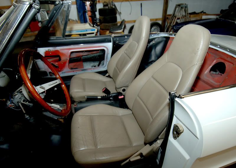

I've sen Miata seats, that's the best bet. Someone here has shown photos of theirs recently. With the right mounts you can get them lower, they'll have to be custom mounts FWIW.
I put a couple Miata seats in the 74 I'm finishing up a complete restoration on. I got them right down on the floor and the height is really close, elbow on door feels right and l'm looking out at the same height above the steering wheel as I am in the GTV.
