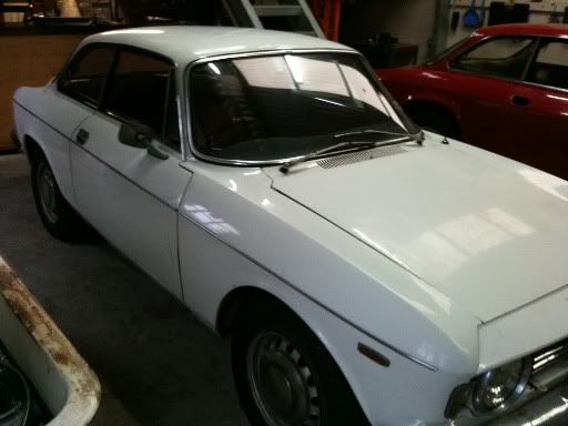

Here is a pic of the car as it was found and then onto the flat bed for the journey. Thanks to Marco Fazio from Alfa Romeo for the historical information on this car.
"According to our documentation files, the chassis number AR 298226 originally corresponds to an Alfa Romeo Giulia Sprint GT Veloce RHD (105.37), engine series AR 00536, manufactured on the 8th June 1966 and sold on the 10th June 1966 to Alfa Romeo Australia. The body colour is hawthorn white (AR 013), with leather skai interiors."
Stored Exterior
Stored Interior
On the truck
Got the car to the workshop and gave it a good pressure wash - found it came up pretty good under that inch of dust and grime. Stainless bumpers intact - need some work but most of the rubber seals had perished - I didn't bother trying to start it with a fresh battery - after so long not being turned over the oil and fuel would have perished and the brittle fuel lines may have leaked. Clean and start the dismantle. Interior in original condition but very tired. Seats are good, dash is still in accptable condition for its age and the fact it's pressed cardboard, guages and what not are ok but need a good restoration, visible signs of rust in front lower wheel arches and some bog in the rear wheel arch area but overall pretty good. 1750 motor with the car - not many spares.

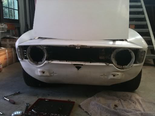

Started the strip down from the front first and found that the car doesnt appear to have been in any major collisions as the panels all appear to be unrepaired and original. The car will be stripped and then media blasted so I'll know the real extend of the body work then. The front clip is in good condition and somewhat rust free, support panels and headlight areas are quite good too.
Strip down front end
Engine Bay

Thanks Franjo, I have seen your metalwork restorations and will be sending some stuff over in the coming week.
Progress today saw the stripping of the bonnet face and it's a good clean unit with only two small low spots and no rust.
Can anyone confirm if this sound deadening material is factory?
Panels are off to the workshop this weekend to have the underside media blasted and prepped.
I also cleaned up the wiper assembly arms to find that the bushes need to be replaced - but how and what with - does anyone have any ideas as to how to replace these plastic bushes?
The motor is a 3 wire which doesn't appear to have any rust so I will send it off for a rebuild this week - I hope they can locate motor brushes ect for it.
