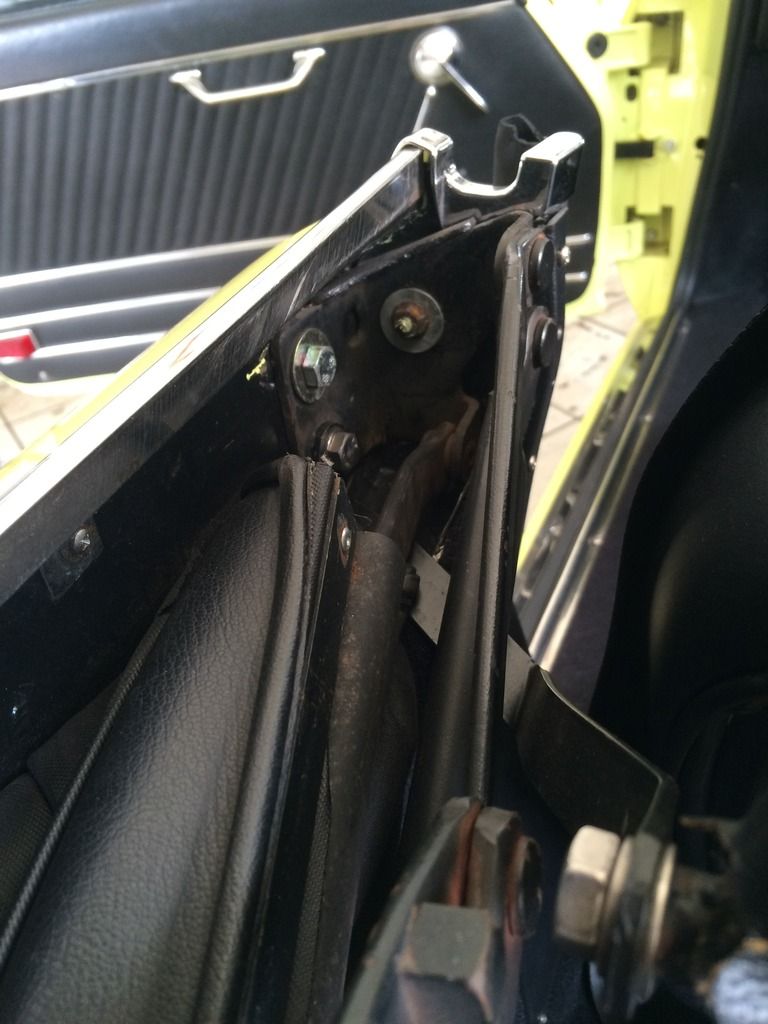

That's not a bad price on the Classic Alfa deflector. I am thinking about purchasing it but have a few questions.
Can someone post a photo or two of the attachment points? Also, Can the top be closed with the deflector in place or must it be removed first? Can the boot cover be put on with the deflector mounted?
Thanks in advance for any help!

here's a photo of the front attachment point.
It uses the lower of the 2 topframe bolts, and you can just see the actual deflector M8 in the foreground.
From there a 2nd bracket bolts to the wheel arch, but i've left those out as I didn't want to drill in there. And found it doesn't really need it after 3 years of extensive use.
The top can move freely with the deflecor up, it's just that when it's down, and you lower the top it get's stuck under the top, so you have to get that up almost completely before you can put the deflector up.
Works perfect.
