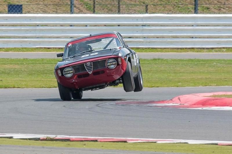

We're using quite soft springs in U2TC racing here in Europe because we have to run old style tyres. You can see that things get quite exciting on some occasions-

Isn't the following true....GTA knuckle risers lower the RC on front suspension, and as the car sits high up the lower RC and relative high center of gravity, cause the car to roll and press hard on the springs. Also the sliding block lower RC, and will therefore make the car push much harder on the springs, also on the front. Hence the car will lift the inner wheel on the front.
Spring rates are defined by RC and CG. Ideally you want to as low as possible on the spring rate, hence you want to raise the RC a bit and lower the car a bit, so both RC and CG come closer together which will allow for using lower springrate, without more roll.
