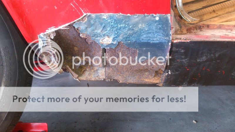

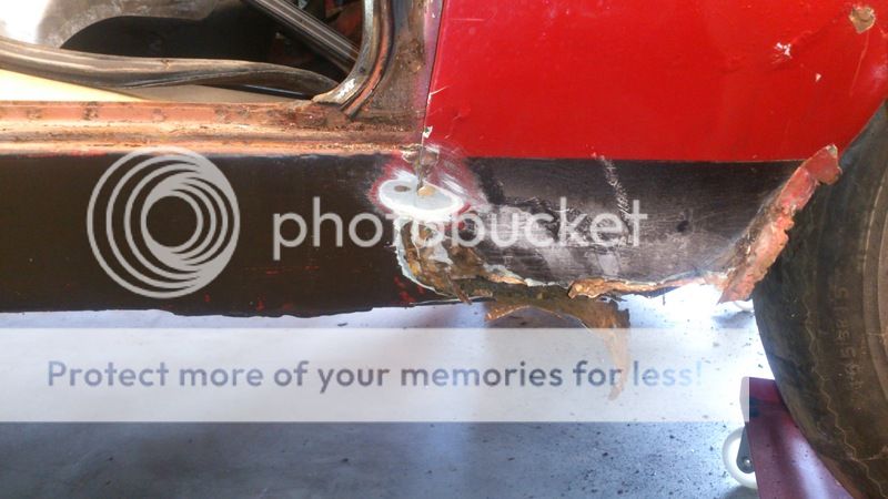

Here are some of the old "repairs".
Galvanized sheet metal riveted up on the old paint and rust! then alot of bondo and paint.
on the other side the repair was at least brazed. then bondo
