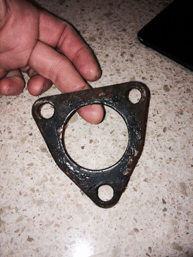

Originally Posted by tdskip View Post
Good morning, the Jr was cut up after it collasped due to rust issues. I have the suspension bits on eBay now. I have hood hangers but not much else left.
Don't suppose you kept the little oval cups ontop the front suspension towers that the dampers bolt onto?
Didn't think so
Craig_m67 is offline
Didn't think so
Good morning. These?
1966 Giulia Sprint $500 junk yard find. I probably overpaid...
1971 1750 Spider basket case , 1972 GTV 2.0 L

Posts: 759
I think this is what he's asking about:
Chuck
Chuck
I'm racking my brain to think where that would go relative to front shocks .... ??????
My 1750 I'm pretty sure does not have anything like that.
