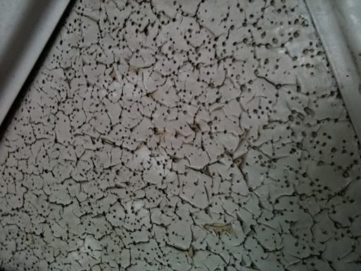

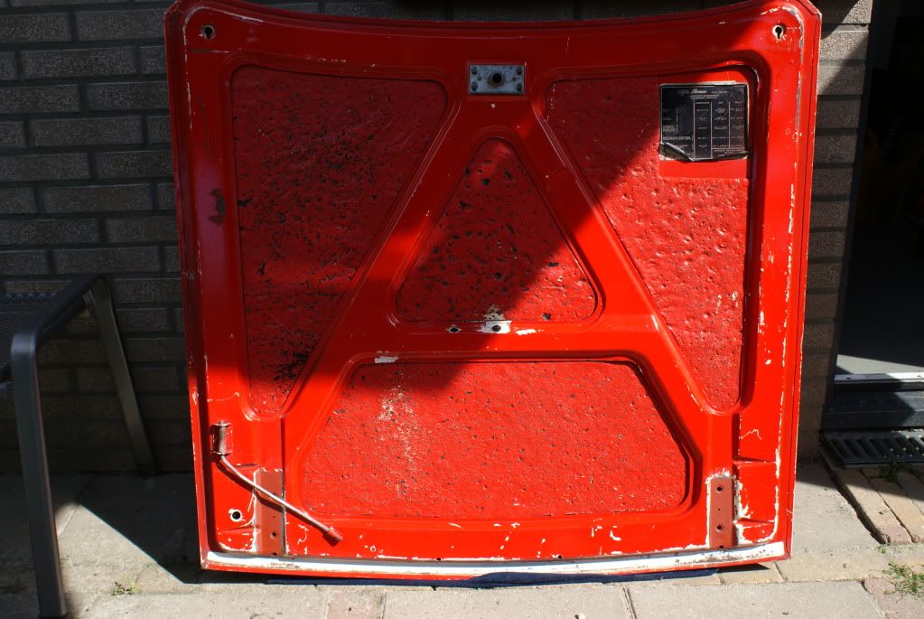

Progress today saw the stripping of the bonnet face and it's a good clean unit with only two small low spots and no rust.

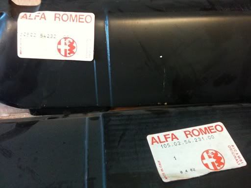

Can anyone confirm if this sound deadening material is factory?
Panels are off to the workshop this weekend to have the underside media blasted and prepped.

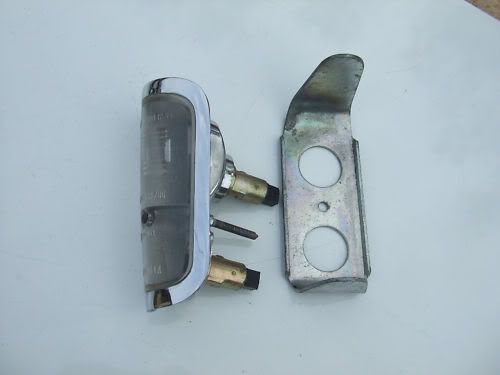

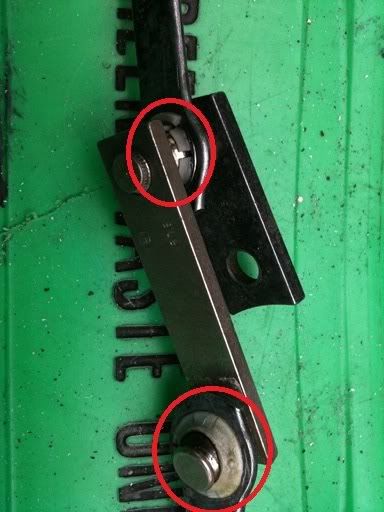

I also cleaned up the wiper assembly arms to find that the bushes need to be replaced - but how and what with - does anyone have any ideas as to how to replace these plastic bushes?
The motor is a 3 wire which doesn't appear to have any rust so I will send it off for a rebuild this week - I hope they can locate motor brushes ect for it.
Yes it is. Here's a early one out of my collection. Heavy stuff but could be removed when heating it a little.

Dry ice blasting is supposed to be the new way to go, but it will not remove heavy corrosion, and you may have difficulty finding someone to do it. If there is a company in your area, you need them to blast with 'shaved' ice at first, leaving the 'pellets' until later.
As for the wiper linkages, yours do not look too bad. These are NLA and have been the subject of many searches for decades. One BB member is currently looking into the possibility of using self-lubricating plasticised ceramic joints from a specialist company in the UK, but AFAIK nothing has come of that (yet). In the meantime, I would just lubricate the linkages with the heaviest graphite grease you can find, and leave them.

If I can't find a suitable solution to the wiper arm bushes I may chat to some hot rod shops to see what they may come up with- either them or good custom fab engineering places. I'll post my findings.

I'll also agree that is the factory deadening on the bonnet.

I don't think my 1750's bonnet has any sound deadening. Should it?

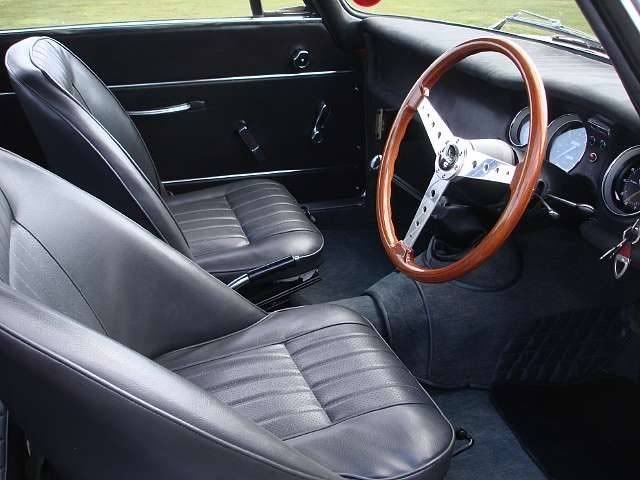

Original interior - well I have a picture of a black interior I really like with a GTA style steering wheel and black buckets, but I don't like the taxi style matte vinyl flooring that the GTA has though.
Here is that picture I spoke about
The door cards and seats will be leather with the flooring carpet. No rear seat and no stereo as such - maybe an ipod directly connected to a small amp and some hidden speakers - no radio. I have some NOS instruments that I will be popping in there. Speaking of which some more NOS packages arrived today I'll post some pics soon.
Pete, Not sure on the 1750 sound deadening material, I would have thought that it would as a heat barrier.

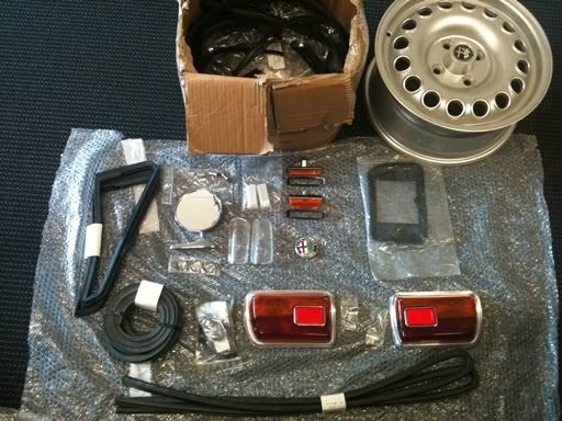

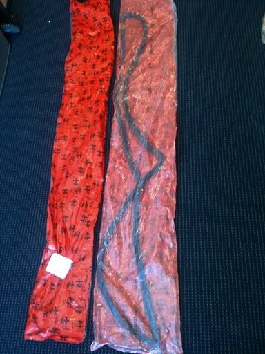

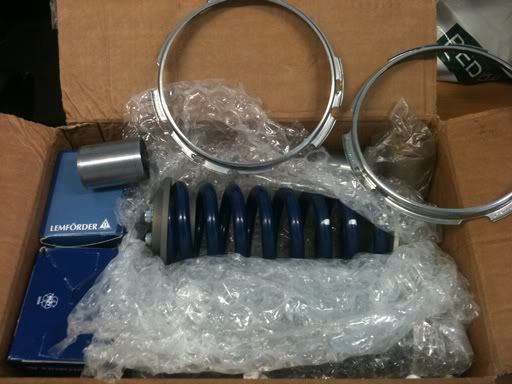

After seeing some of the great restorations on here I got a little carried away online and subsequently a few boxes of items have shown up on my doorstep over the last few weeks - weeks of searching and lots of luck. Thanks to the guys at Classic Alfa and Alfaholics to name only two stores that have assisted in sourcing some of these items.
How have people found the 4 wire wiper motor? Are there any gotchas with respect to the speed or mechanism ? Does anyone know if the Magnetti Marelli mechanism needs different mount points to the Bosch type units or is it a straight fitment? This weekend sees the start of the body stripping!
Thus far covered at the moment: wheels - 15" GTA Reps, tyres - Yoko Neova AD08, full suspension components Alfaholics full "Kit C" with all new rods, joints and bushes (front and rear), car seals and rubber kit some NOS some repro, NOS Carello head lights and some chrome work and panels. I've also sourced a 2L 105 based Nord motor. Left to organise now are brakes, interior, electrics and more replacement panels as well as misc items such as wiper motor/mech and the drivetrain.
Anyone have any NOS items they'd like to part with pls pm me.
Here are some of the items that have landed thus far with more in transit:
More to come as it happens.
