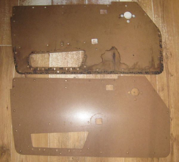

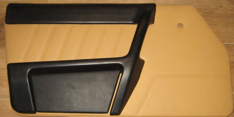

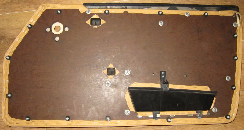

I've just finish to restore my door pannels... I'm so glad because they are as pretty as new ones !!!

No I didn't. I only purchased hard cardboard pannel from local do-it-yourself store. The skai was very dirty so I cleaned it with a magic detergent (see picture); this liquid removes the 90 % of dirt when good soap removes only 10 %. I bought new plastic clips and stapples of 4mm, and that's all !
