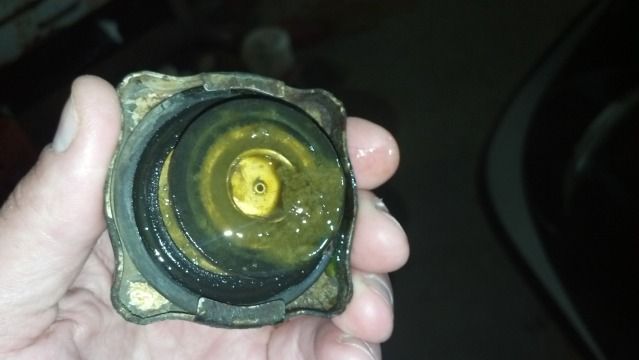

When I purchased the car I took the radiator cap off and the coolant was a nice dark green.
Today I took the radiator cap off and it was covered in brown oil. I took some paper towels and dipped out quite a bit of oil and refilled with antifreeze.
I have looked and the engine oil and it appears to be clean.
I know that I'm looking at a headgasket replacement down the road, but I would really like to wait until the fall before tackling that job.
My question is, how long can I limp along like this w/o doing any damage ? This isn't a daily driver, just nice days, usually on the weekends.

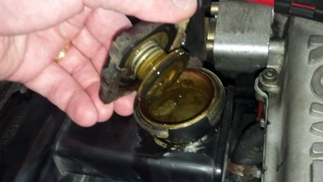

Well, try as I might to pretend that nothing is wrong, I have finally come to grips with the fact that I need to replace my headgasket ASAP
It just isn't any fun to drive the car knowing that something is wrong inside.
Here are some pictures of the antifreeze:
[IMG][/IMG]
[IMG][/IMG]
[IMG][/IMG]
