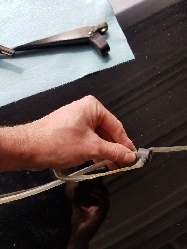

I like how you put tape on the windshield to place the wiper arms back in the same position...wish I had thought of that yesterday!
BTW, I found out why my sprayer never worked after 4yrs of ownership:
Must have gotten pinched from when the DPO fiddled around in there. Also, my sprayers are both clogged from when Maaco had the car last... Just ordered new.
