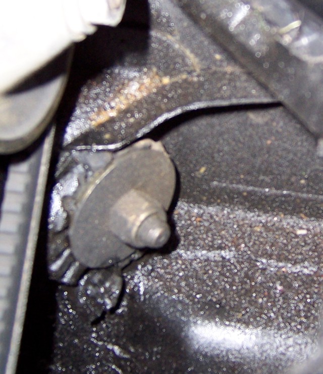

First off, I think I need reassurance that the thing in question is the castor rod... so, is the thing in my picture the castor rod bushing?

Feel reassured.

Nope, no special tools required, just undo the nut/bolt from the top A-arm (control arm), undo the nut you showed in the picture, and pull off. While it is off, take a measurement (although you should get it aligned again after replacing the bushings) of the overall length, then take the opportunity to take the castor rod apart and use some anti-seize on the adjuster in the middle of the rod, that way when you take it for the alignment, they won't tell you they can't adjust the castor due to the frozen rod. And make sure the alignment shop adjusts the castor, I have had several only adjust the toe, so you might want to mention that and verify it on the specs afterwards.
