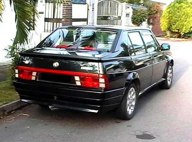

I have the exact same wheels on mine.
Itīs not an easy fit because the center hole had to be enlarged to 58,5mm (itīs 58mm on recent Alfaīs).
After this, just pull out your olīstock "14 and fit the 156 in
The offset sucks, though...Iīm fitting wheel spacers soon.
Here are some photos:
(and yes...itīs lowered...3cm front 4cm back )

Originally Posted by AdrianoM
Thanks for info! Why do you fit spacers? Is it really a problem? I would use 195x50 (or55) tires if 15" deal goes right (ought to check if our craftful mechanics are capable of boring 0.5mm bigger holes
Wheel spacers are not a problem.
Itīs just to bring the offset back to ET30
About the tires...I am runnig on Michelins 205/50R15.
195 looked too skinny on the 75...
75 TS (modded) - 1993
166 2,4 JTD (modded) - 2001

Posts: 83
instead of opening the bore of the wheels, i had custom spacers, 58.5mm to fit hub and 58mm to fit wheels. front spacers 20mm and 25mm on rear.
car's not lowered which should be.
