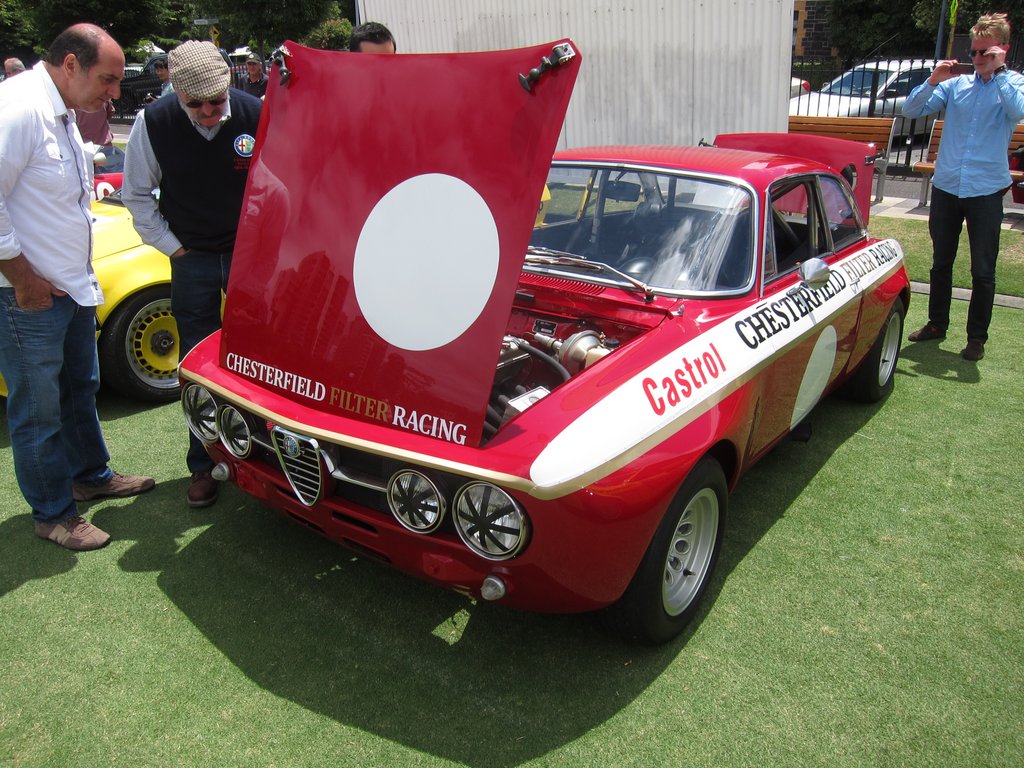

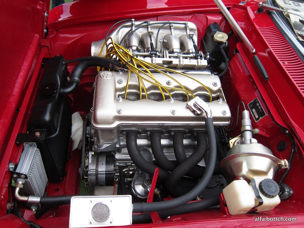

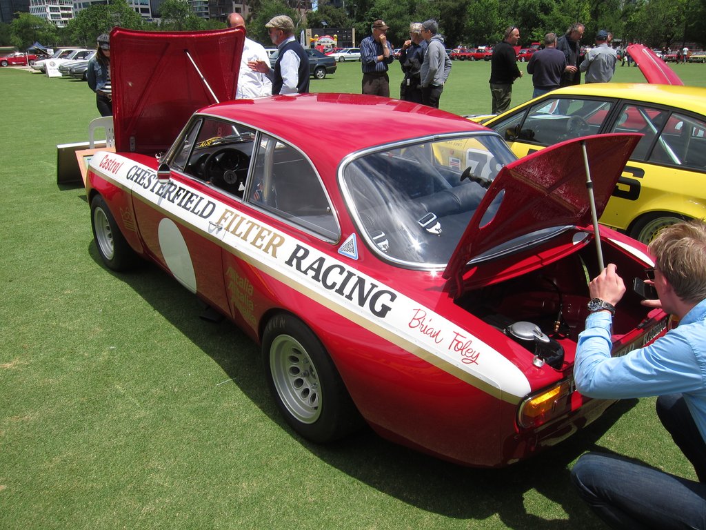

I was surprised when it was pointed out to me that news had not reached Alfabb of the restored Brian Foley GTAm, revealed at the AROCA Spettacolo display last Sunday. Attached are some of my average photos, but there are many more. Needless to say the car attracted a LOT of attention...
Edit: Strange I'm not able to make attachments. I'll link the images instead, sorry if they're slow to load.

Because there was never was any RHD 10551 GTAms! LHD was how it was made and delivered and competed in period in its 4cyl form.
Don't look too closely at the pictures; you will see that while all its original basics are there, there is also a lot of small items and finishing off to be done yet.
I wouldn't normally present an unfinished project, but the event organisers had arranged to fly Brian Foley down for the weekend, so it sort of had to be there regardless.

Hey Vin, did you ever take any photos of the way it had been converted? I've heard it was done using the LHD steering and idler boxes mounted on the outside of the rails to give additional room for the tasman v8 and exhausts?
I assume the steering wheel was a bit off from it's original position as a result?
#9 ·
With the t33 V8 fitted it was shifted to RHD by locating the LHD steering box outboard to clearance the engine bay as stated above. This was in '72.
