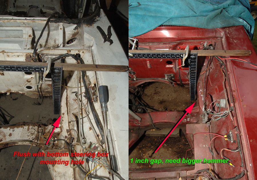

Here is the problem, on the vertical wall where the steering box mounts is wavey. I can take a straight edge and see at least a half an inch of daylite, whereas on the white parts car it is straight,
I would like to take the front and fenders off and have that exposed for repair. Any suggestions on the best way to take the front and fenders off?
The fenders are spot welded on. The front is butt welded on to the fenders.
I would be afraid that the fenders and front might be really tweaked. If they are, you may have one heck of a time putting them back on.

With out the exterior sheet metal off, you will be pulling against that outer shell as well and it WILL wrinkle. (If you want, ask how I know that!) Once off, you can restore the front stub frame. Metal has a "memory" and will come back closely to where it was originally assembled. You will have to pull just slightly further to get it to stay straight.
I have a concern as to why the rear sheet metal was swapped out, and that bears a close inspection to determine if the car had only sheet metal damage back there, or structural damage as well.
Obviously the front end sheet metal was installed after the damaged exterior body work was removed, and, as mentioned above, the current exterior sheet may have been altered to fit the twisted front end. It will have to be altered again, in some areas to fit the correctly dimensioned stub frame.
I am VERY familiar with this situation, having done this identical job. One thing to constantly watch is maintaining correct front suspension mounting points in relation to one another, both right to left to firewall, and upper and lower to one another and firewall. Failure here gives you a straight body and stub frame, with crooked front suspension mounting points.

I got the white car cleaned up and inside on rollers. This may be the long hard way of doing it but I was thinking of taking the crossmember and frame rails from the white one and putting them on the red one?

Here is what I'm dealing with. Fender/s would have to come off. The vertical panel would have to be straight/vertical. Basically have to take the car apart and would like to use the good white panel in the red car. Or replace all the floor pans and inner,middle, and outer rocker panels and all wings on white car. I need a project but not a Waterloo.
ideas?

How about removing everything from the firewall forward and grafting on that same portion from the donor car?

That's kinda my thinking. Actually taking one apart that far will be interesting. If anyone has ever done that I'd sure be much obliged fur some sort of order and method. I don't have any jigs or special tools but just enough knowledge to screw up two cars. But hey, what have I got to lose. Granted I could put the red car back together, it has had all the rust fixed did drive straight and lined up fine but it would never be near worth the effort it would take to get it back to this.

It's called "clipping" and really should be done by an experienced bodyshop. People who are good at this can make one car out of two and it's hard to tell where one begins and the other ends. In the days before "salvage titles" it was fairly common for junk-yards to rebuild total write offs into more or less viable cars. It's skilled work but if you can find someone with the experience to advise, you'd have a great project.
