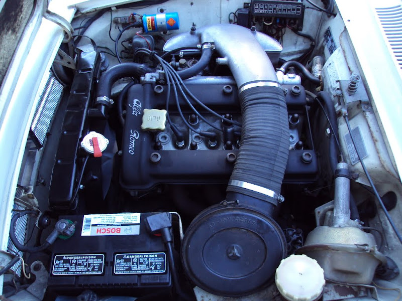

Are you going for a concourse or period correct clamp (if there was such a thing)? I have standard hose clamps on my 1600 air hose. I can get the size number for you if you'd like.
I have always wondered where to source the air hose itself. I found this one on eBay years ago but the stupid plug wires I had on there wore holes into it.

Original 96mm clamps will not work on the repro hose that Highwood and others sell. The last one pictured with sharp edges instead of the rounder profile of the original on Kais GTV.
It has a thicker wall so the stock clamp is not long enough.
So Dirk, which hose do you have ??
