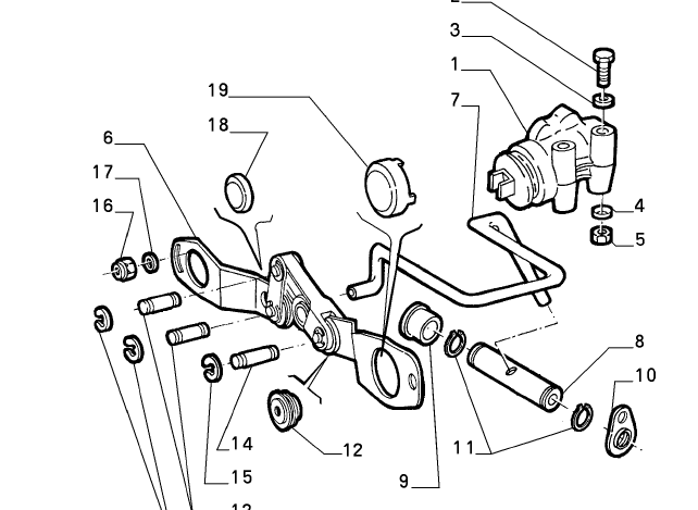

Does anyone know where i can find these or if there is an alternative? It's number 12 in the diagram below

item 12 - 60576781 bushing unit takes two of them
item 6 - 60511712 complete lever assy with bushings installed.

Yeah. I ordered a pair of bushings from difatta but they were to brittle. Jason, let me know what a new linkage w/ bushings would cost.

Those bushings are suppose to be hard.

The slightest pressure and it crumbled in my hand.

Then you got junk. I can get a new one or I may have a good used one.
